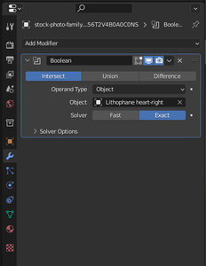

Now we will cut the right side of the heart. You can select one of the photo and add the Bolean modifier with the Intersect mode. In the Object choose the Lithophane heart-right mesh. Now if you hide the Lithophane heart-right mesh, you can see that the photo got cut.
Do the same with the other photo and the Lithophane heart-left to get the other side of the heart.
