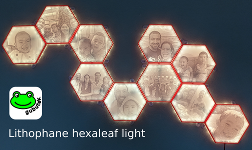

In this project, I used led strip and lithophane photo to make decoration panels. Each module is a hexagon panel and can be used to make different shapes (nanoleaf alternative).

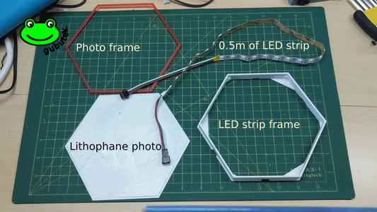

For each light panel, you will need
  • 0.5m of LED strip,
  • the hexagon frame for the LED,
  • the lithophane photo
  • the photo frame.
If you don't want to use lithophane photo, you can print the photo.stl file. It is a flat photo and works like a diffuser.

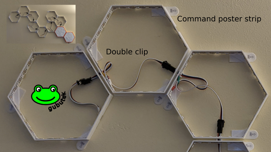

You can use glue gun to fix the endings of the strips. You can arrange all the hexagon modules on the wall according to your pattern. To attach them on the wall, I use
  • the command poster strip which can be easily removed when I need to change my pattern.
  • the double clip to fixed the connection cable between modules.
Step 4: Power You Panels
The final step is adding the controller and power supply for your panels. It depends on the type of LED you chose. I used the 2812b with the bluetooth controller so I can use my cellphone as a remote. There are many choices so pick whatever you feel like and enjoy.
