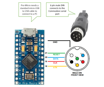

Next, decide the Arduino / clone to use, which also determines the cable needed to connect to your PC.
- The Pro-Micro needs a standard micro-USB to USB cable

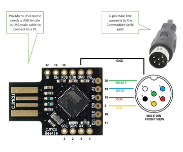

- The Pro-Micro USB Beetle needs a USB female to USB male cable

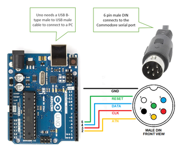

- The Uno needs a USB B-type male to USB male cable
To connect the Commodore and Arduino, prepare a cable as shown in the diagrams.
- Soldering wires onto the 6 pin DIN connector is a bit tricky, so it's worth checking YouTube videos for tips if not done before
- Any digital pins may be used. The digital pins used in these diagrams are working examples
- The Arduino pin connections need to terminate as male pins for the Uno. For the others, usually female pins are required (depends on the choice of header pins used)

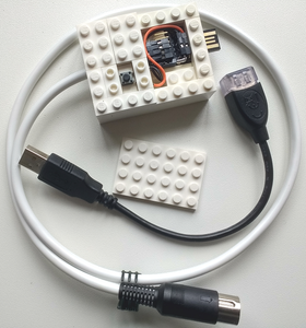

Having a reset button is useful for restarting the Arduino which is occasionally needed if a program fails in loading. The Arduino Micro and Uno already have one but many Arduino clones do not.
- To make one, a momentary button needs to be connected between the reset pin (usually labelled RES or RST) and ground pin (GND)
- Alternatively, the Arduino needs to be re-plugged in to reset it
A picture is shown of a completed, working example using a Pro-Micro USB Beetle with a reset button mounted in a Lego case. I chose the Pro-Micro USB Beetle as my main device because it is the smallest option and has a sturdy male USB header for the PC connection.

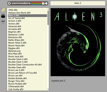

- Box art images are optional, but if used must be located in the resources/art/c64 and resources/art/vic20 subfolders and given the same name as their corresponding program with a -image.jpg extension, e.g. Blue Max.d64 should have an associated image called Blue Max-image.jpg
- Optional help information can be added into the resources/info_c64.js and resources/info_vic20.js files for each program as shown in the example below

The simplest scenario is where all board pins share the same AVR-chip input and output port names, such as the example below used for the Arduino Uno in this case.
Atn mapped to board pin 2 (D2) is PD2. The PD pins have an input port name PIND, output PORTD, mode (not used here) DDRD
Clock mapped to board pin 3 (D3) is PD3
Data mapped to board pin 4 (D4) is PD4
Reset mapped to board pin 5 (D5) is PD5

- Open index.html in Chrome, Edge or Opera
- Click the Open files icon then navigate to a folder containing D64, PRG and T64 programs
- To select all files, click on one of them then press CTRL + A together and then choose Open
- Turn the Commodore on and click the Connect icon to select an Arduino device and connect to it
- From the program list, choose the program to load
- On the Commodore, issue the required LOAD command
LOAD "*",8 used to load the selected D64, PRG or T64 based program. The disk drive number is always 8
LOAD "*",8,1 this version of the load command is needed for many Vic-20 games and some C64 games. The program will be loaded at the memory location given in the first two bytes of a PRG file
LOAD "ABC*",8 for D64, T64 programs, used to load a program starting with certain characters (e.g. ABC)
/* shortcut for LOAD "*",8,1 with C64 EPYX fast-load cartridge only
RUN runs the program following LOAD above
LOAD "$",8 loads a directory listing of the contents of a D64 or T64 file
LIST lists the directory contents after the above
$ shortcut for LOAD "$",8 with C64 EPYX fast-load cartridge only
- The Search web icon searches for the selected program on the Internet, providing a shortcut to get more information about it
- Directory listings showing the contents of D64 and T64 files are displayed by clicking on the associated art image. They are automatically displayed if no art exists for a program
