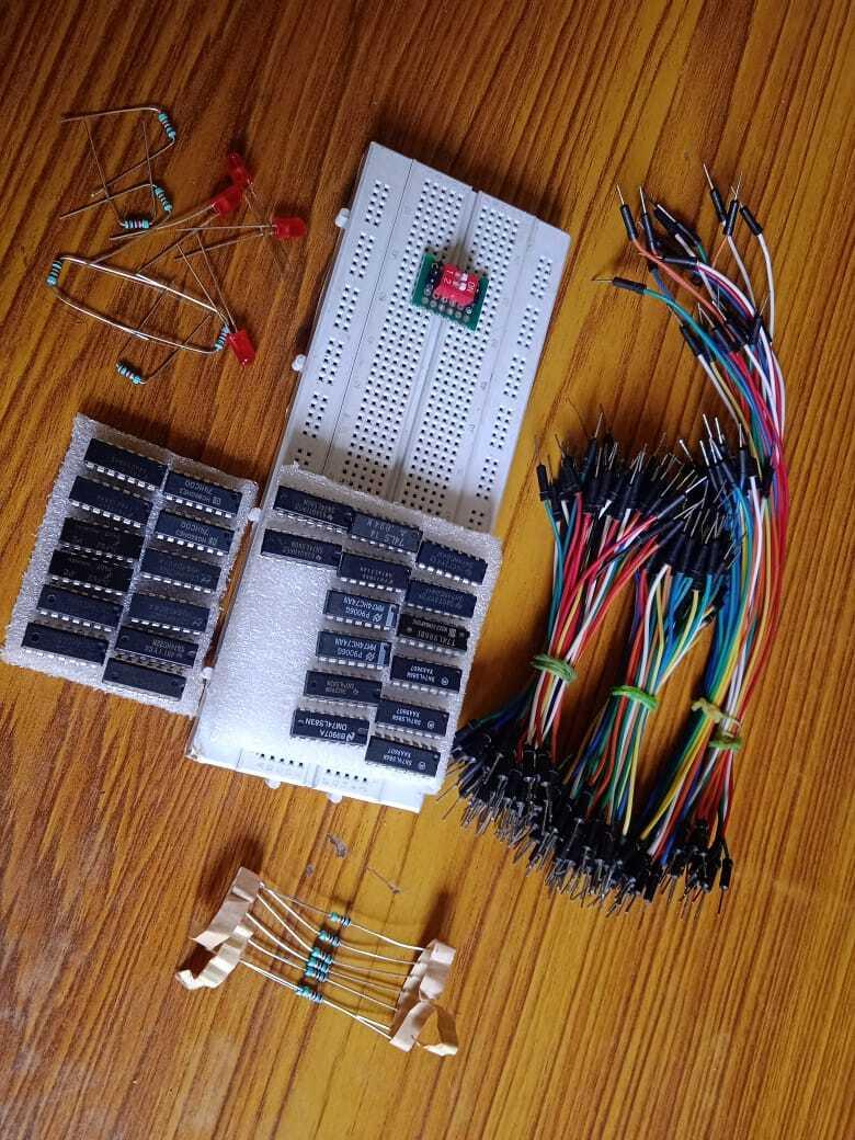

Electronic Components
https://quartzcomponents.com
- Passive Electronic Components
Resistors
- 1K
https://quartzcomponents.com/products/1k-ohm-1-4-w...
LED
- LED (RED)
https://quartzcomponents.com/products/red-5mm-led?...
- Active Electronic Components
Logic Gate ICs (TTL Family of Logic gates)
- SN74HC32N ( Quad 2-Input OR Gates)
https://quartzcomponents.com/products/74ls32-quad-...
- SN74HC08N (Quad 2-Input AND Gates)
- SN74HC04N (Hex 1-Input NOT Gates)
https://quartzcomponents.com/products/74ls04-hex-i...
- SN74HC02N (Quad 2-Iput NOR Gates)
https://quartzcomponents.com/products/cd4001-quad-...
- SN74HC00N (Quad 2-Input NAND Gates)
https://quartzcomponents.com/products/74hc00-nand-...
- SN74LS86N (Quad 2-Input EX-OR Gates)
https://quartzcomponents.com/products/74hc86-quad-...
Bread Board
https://quartzcomponents.com/products/colored-brea...
Jumper Wires
https://quartzcomponents.com/products/65pcs-breadb...
2 Positions DIP Switch
https://quartzcomponents.com/products/dip-switch-2...
PCB

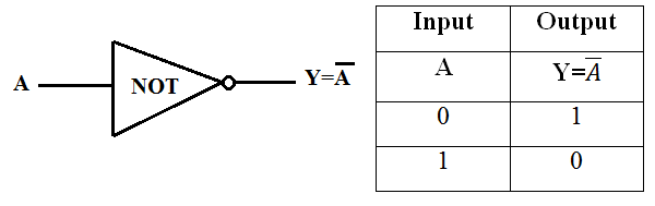

NOT Gate is a little bit different from above two gates (OR and AND). NOT Gate has only a single input and a single output. Logical symbol and Boolean expression of NOT Gate has been given in Image-3. The NOT Gate is also known as an Inverter or Inverter Gate because its output is invert or complement of its input.
Boolean Expression For NOT Gate is
Y = ~A (Read as "Y is not equal to A" or "Y is equal to complement of A")

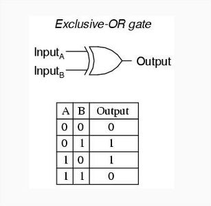

EX-OR Gate has two or more than two input terminals and only a single output terminal. Symbol and Truth table of EX-OR Gate has been given in Image-1.
Boolean Expression of EX-OR Gate is following
Y = A ⊕ B (Read as "Y is equal to A EX-OR B")
