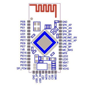

When it comes to CSR pinout its very simple:
SPK_AP - left speaker positive
SPK_AN - left speaker negative
SPK_BP - right speaker positive
SPK_BN - right speaker negative
GND - ground
VCHG - voltage input
LED1 - led output
Thats it. No amplifier etc etc.
