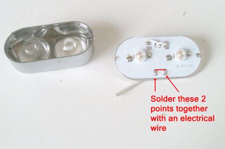

Solder everything together on the solder board.
If you use ready-to-use LED's, you have to bridge the resistor in the LED casing.
