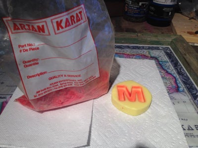

The first step is to decide what you want to cast, I chose to make handles for a china cabinet that I had made my wife. I bought the letter m mold off of eBay, you can always carve the wax but I wanted to make multiple molds in a short period of time. I also bought injection wax off of the internet, it holds heat well and cools very hard. I took my heat resistant glass measuring cup (Pyrex) and melted my wax in the microwave, melting times will vary by microwave. Be careful if you get the cup to hot it will crack or start to melt itself ( both of these happened to me). After you melt your wax pour it into your mold, it will take around thirty minutes to cool. I used this time to make the stud for the back of my mold. I drilled a 3/8" hole in a 1x4 with a forstner bit, i used the forstner bit so the sides of the hole will be smooth. I then screwed another 1x4 to it to make a back to stop the wax, then poured wax into the hole. I actually made about 24 studs at a time. You will need extra studs to leave vent holes for escaping gas. After all the wax cools and hardens you take the stud and letter m and marry the two with hot wax. ( I used pam on all molds to help the wax come out.)

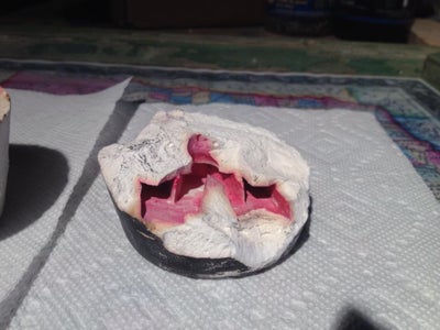

The next step is to put the wax into the plaster of paris, you mix up the plaster according to the directions and pour into a container. I used Styrofoam cups for this, it made it easier to get the plaster out. After mixing up the plaster gently place the wax mold letter down leaving the studs at the surface of the plaster. The next step is to fire the plaster, this serves two purposes to melt the was out leaving a negative void for the hot metal to go. Also it tempers the plaster, taking all the moisture out of it and making it harder. ( this step is important, if you don't do it the plaster may explode). I used an old cookie sheet and my bbq grill, you turn the molds upside down and turn the grill up 3/4 of the way for about thirty minutes. Make sure to keep an eye on it so that nothing burns up. Now your ready for the metal.
