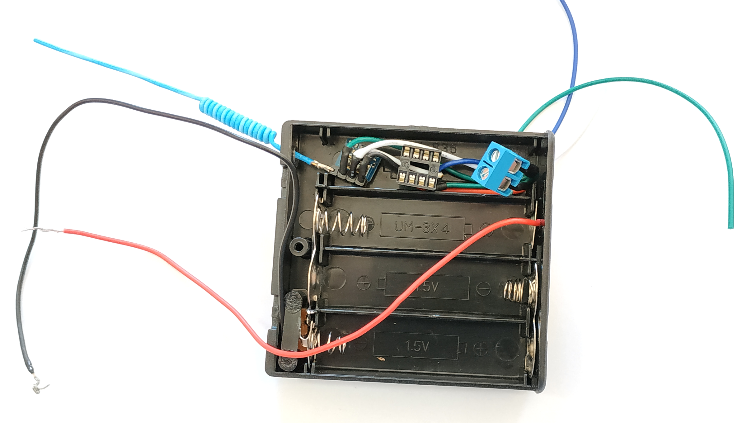

For transmitter-sensors we will need the following components:
Total 3.63 $;

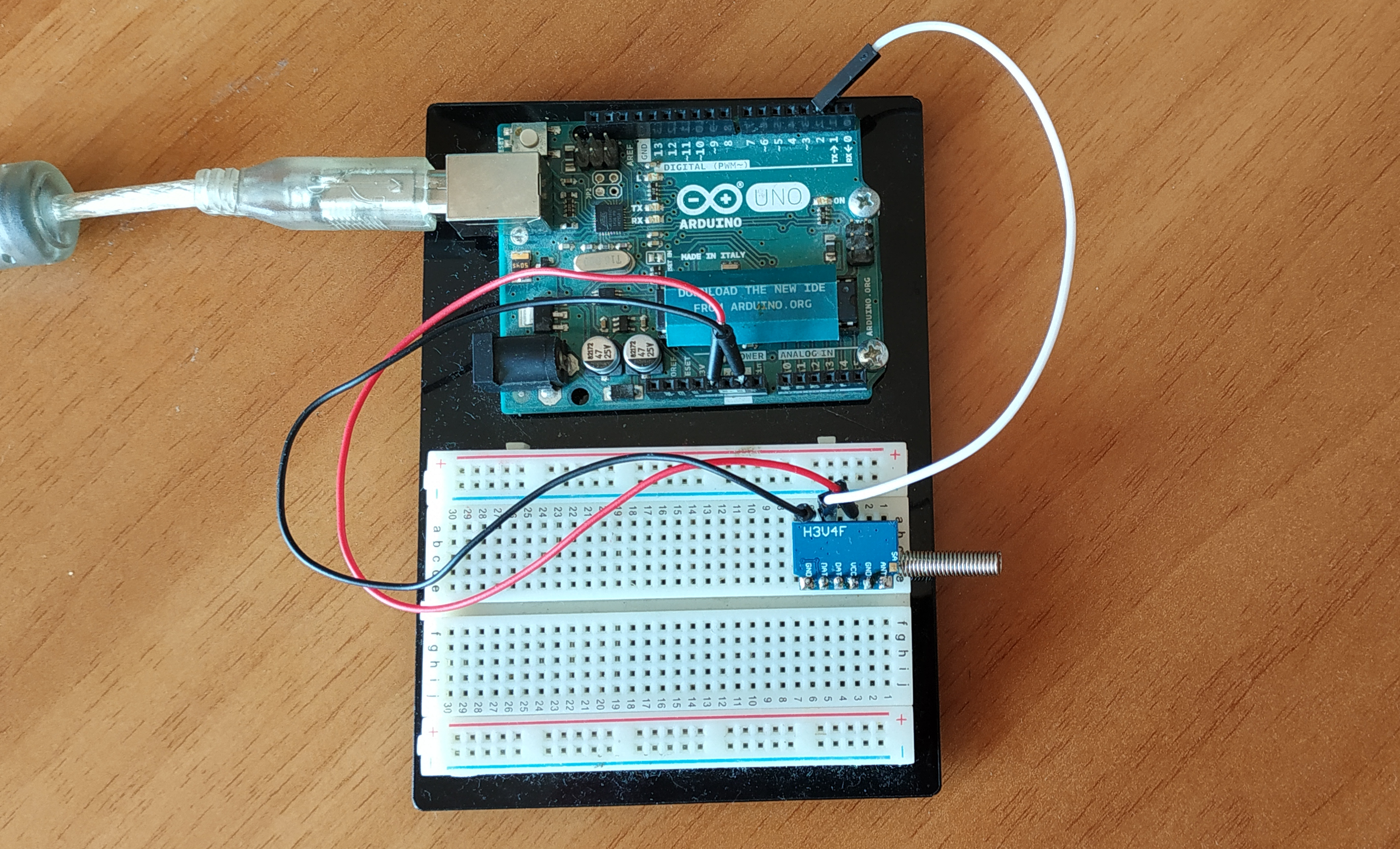

The receiver used for the tests is an Arduino UNO (only for testing) and a H3V4F receiving module (0.66$) with a cheap arc antenna (0.32$).
Sensor-sender schematics

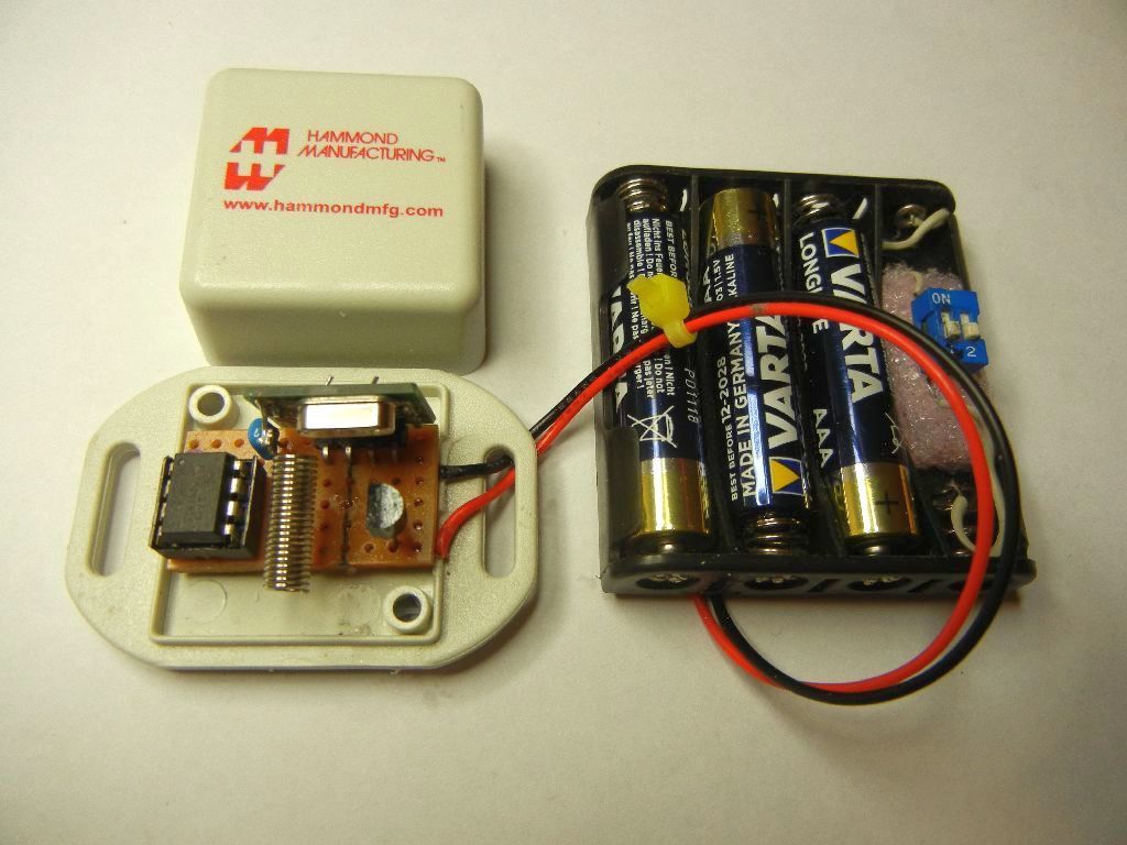

The transmitter-sensor units are powered with 3xAA, 1.5v batteries (in the fourth compartment of the battery holder there is the electronic assembly). As you can see the transmitter’s power supply and the temperature-humidity sensor is hooked to the PB0 pin of the microcontroller (the transmitter and the sensor are powered when the pin is set to HIGH). So when the microcontroller is in deep-sleep mode, it can reach a 4.7uA current consumption. Considering that the wake-up time of the transmitter-sensor would be about 3s (measurement, transmission etc.) and the average time between transmissions of 180s (as the example in the previous chapter), the batteries should resist quite a lot. With some good quality alkaline batteries (i.e. 2000 mAh), autonomy could be over 10 months as calculated on omnicalculator.com (where the total current consumption is: sensor - 1.5mA, transmitter module - 3.5mA and ATtiny85 microcontroller - 5mA, total 10mA).
In the photo below you can see the almost finished sensor-sender assembly.
Below is the photo of the test receiver unit.

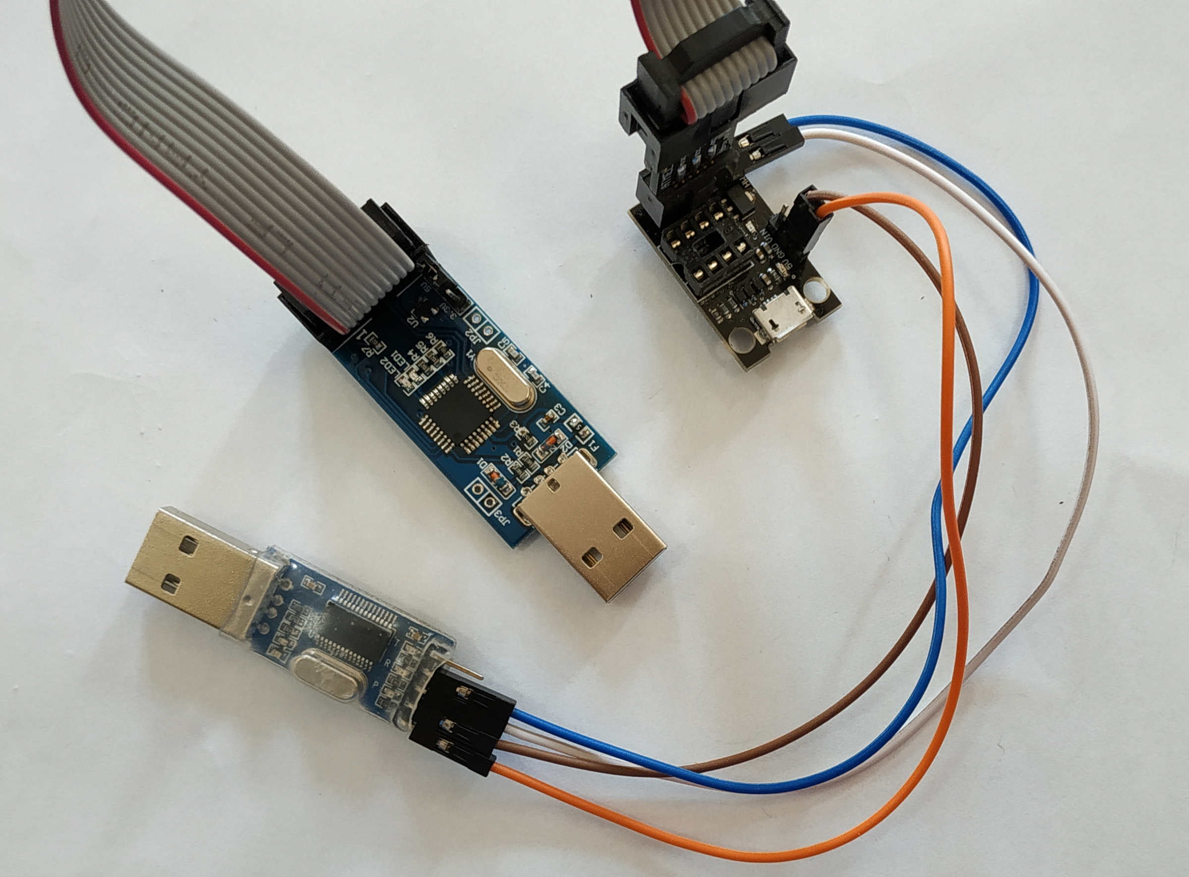

The software uploaded running to the attiny85 microcontroller, the main component of the sensor-sender units, has the purpose to read the data provided by the sensor, convert it to be transmitted by radio, and transmit it within Poisson time frames (exponential distribution or PASTA - Poisson Arrivals See Time Averages). Also, by using a simple function, it monitors the status of the batteries and gives a warning if the required voltage for the sensor is no longer provided. Source code is available on github. The code for the test receiver is very simple I'm posting it below.

For debugging I used the softwareserial library and the attiny85 development board with the USBasp programmer(see also my instructable about this). The serial link has been made with Serial to TTL converter(with a PL2303 chip) connected to the bent pins (3 and 4) of the development board (see picture below). All of this has been of an invaluable help to complete the code.
