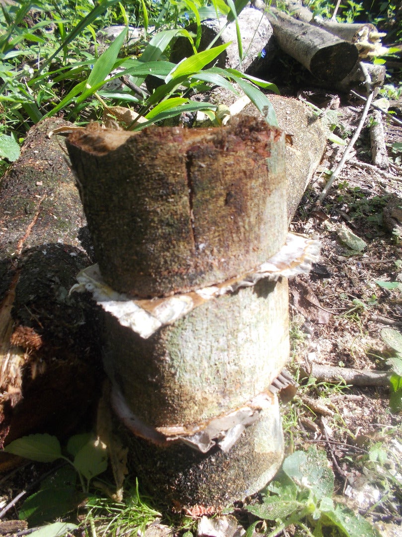

Step 7: Layer Between Timber Biscuts
Now take the cardboard from the zip-lock bags and unroll them. Layer them between each biscuit. I only make them 3 high. You can go as high as you want but I find critters knock them over sometimes. Water every week for the first few weeks. Now leave them in a shady position and wait for the biscuits to become colonised...this may take a few months.

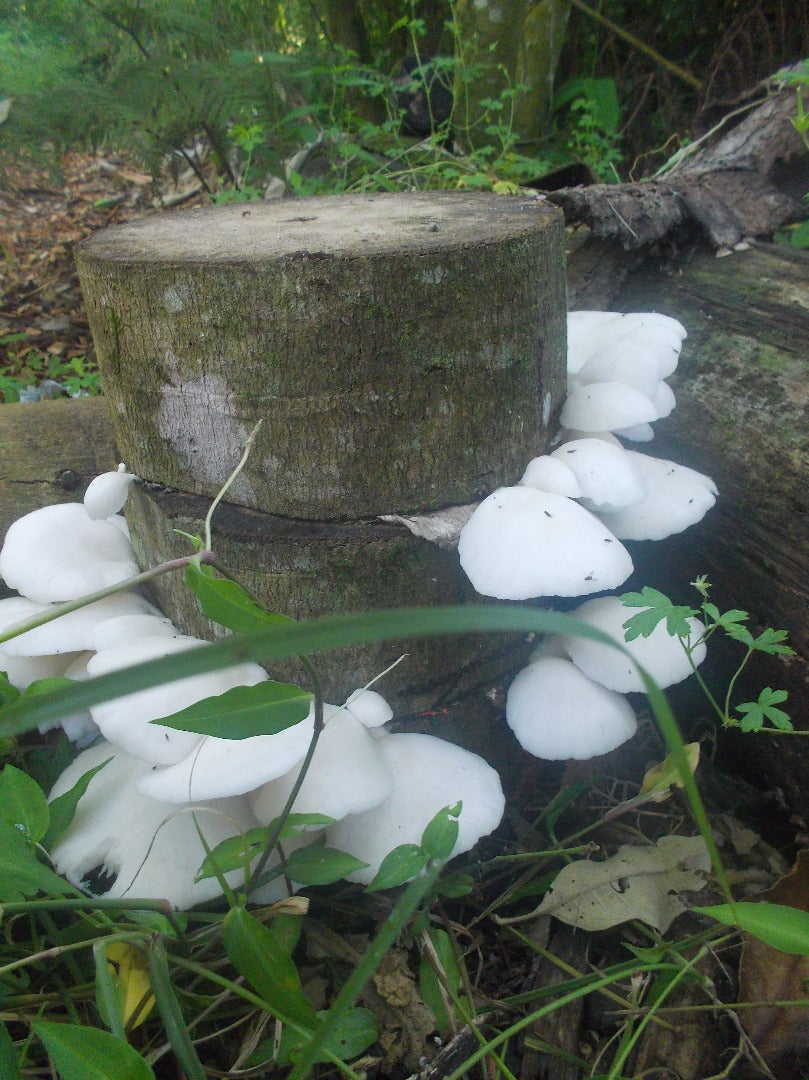

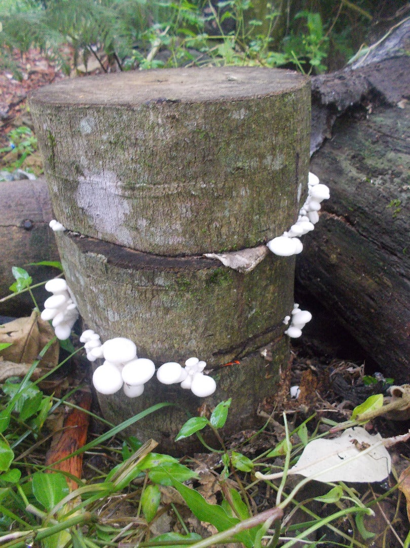

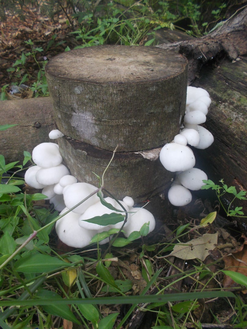

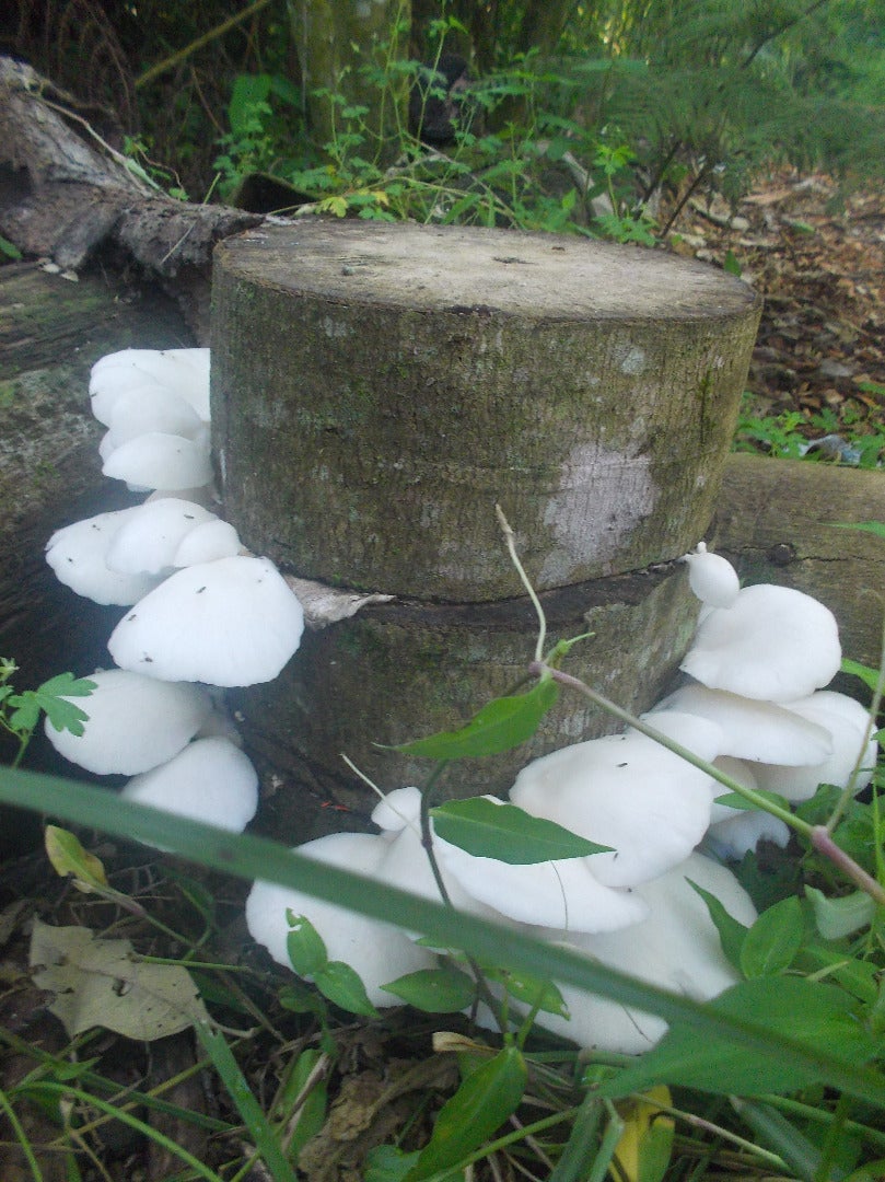

Step 8: Ready to Eat
The weather cooled down and we had some rain and bam! Mushrooms!
These ones took about 4 months to fruit on a local tree called Pencil cedar.
They are ready to cut off and eat. I use a knife and sometime I wash them if they need it.
The most important thing here is that you put the logs somewhere you go regularly. You can miss them easily, if you don't visit the often. The size of the log and type of timber will determine how long before it fruits and how many times it fruits. Bigger logs take longer to fruit but will fruit more times. I have had logs that fruit 3 times a year for 2 years.
