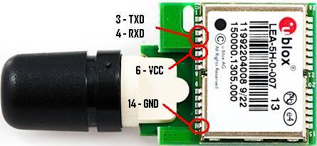

For my projects I have used the GS407 receiver (http://www.sparkfun.com/products/9436). This is a small receiver with a helical antenna that gets great reception. The U-Blox chipset can interface with the U-Center software to set all the device parameters and update the satellite almanac for faster startup times (http://www.u-blox.com/en/evaluation-tools-a-software/u-center/u-center.html). Using U-Center you can also update the "dynamic platform Model" which allows this receiver to operate above 60k feet. You must set the dynamic platform model to "Airborne < 2g" or higher to operate above 60k feet. I'll discuss how to change that setting after we have the GPS and radios connected.
For now all we have to do to the GS407 is solder 4 wires on. In the picture you can see that the serial communication comes out of pins 3 & 4 of the U-Blox module. Pin 6 is VCC or power and pin 14 is ground, which you also need as a reference for the serial bus. Solder a wire to each of these pins, you should be able to do it without a microscope using 30 gauge solid core wire. If you use 4 different color wires you'll make your life easier, too. If you feel nervous about soldering these wires you can buy a breakout board (http://www.sparkfun.com/products/10496) for the GS407 that will provide slightly larger holes to solder to, but you're still going to have to solder.

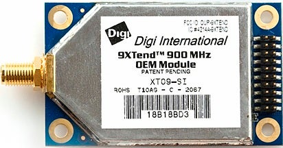

My last balloon used the XTend 900 radio module from Digi (http://www.sparkfun.com/products/9411) as the main communication system. This 1 watt, 900 MHz radio allowed me to keep communication with the payload for the entire flight while getting flight data updates once every 5 seconds. The XTend 900 can interface to the XCTU configuration software to change the serial data rate in a user friendly GUI way (http://www.digi.com/support/productdetl.jsp?pid=3352&osvid=57&s=316&tp=5&tp2=0).
On the PC side of things you need to connect the XTend 900 to the PC's USB port. The best way to accomplish that is to get the uUSB-MB5 USB to serial converter from 4D Systems (http://www.4dsystems.com.au/prod.php?id=18) and the XTend breakout board from Sparkfun (http://www.sparkfun.com/products/9596). Solder the breakout board onto the XTend 900 or buy the proper connector. Then solder wires from the uUSB-MB5 to the breakout board in this order:
-uUSB-MB5 RX to breakout DO
-uUSB-MB5 TX to breakout DI
-uUSB-MB5 GND to breakout GND
-uUSB-MB5 +5V to breakout VCC
-On the breakout board you will also need to solder a 10k resistor between SHDN and VCC.
The balloon payload is similar and you'll need another breakout board to make things easy. Solder between the GS407 and XTend 900 breakout board like so:

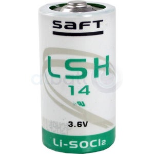

For my Night Sky balloon payload I discovered lithium thionyl chloride batteries. These batteries have an amazing power density, but aren't rechargeable like lithium polymer batteries are. You'll only need one LSH14 battery from Saft (http://www.tnrbattery.com/Saft/battery/LSH14ST.html). Make yourself up a connector to attach and detach the battery from the XTend 900 breakout board on the balloon payload. Solder one wire of the connector to the VCC on the breakout and the other to GND. Do the same on the battery with the other side of the connector.

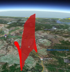

This is a surprisingly simple step. Go to http://weather.uwyo.edu/polar/balloon_traj.html.
- In the "GFS model time" drop-down, pick the time that most closely matches your launch time (note the times are in Zulu).
- Leave the forecast period on Analysis.
- Enter the decimal degrees for the latitude and longitude of your start location (you can get these from Google Earth, look at the bottom of the screen while moving your cursor over the map).
- Pick the height you expect your balloon to go (this is usually given by the balloon manufacturer).
- Lastly select GoogleEarth KML as the output and click Submit. You'll get a KML file that you can open in Google Earth and see the expected flight path.
Note that this prediction assumes a 1000 foot per minute ascent and descent rate. The altitude in the KML file also appears to be shown in meters, but the text labels are in feet...
