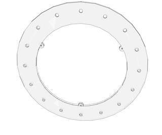

Step 10: Fabricate a Light Ring
I used a 3D Printer to produce my LED light ring.
- If you don't have a 3D printer... that shouldn't stop you from proceeding.
- This ring is NOT complicated.
- It can be made out of whatever you have:
- plastic, plexiglass, plywood, wood veneer, papier-mâché, even cardboard (use your imagination)
- You could design your own in minutes using TinkerCAD or other 3D Modeling software
- or just download the .stl file (that I've included)
Some notes about MY light ring design:
I added a slight inward angle (10 degrees) to the holes that hold the LEDs... I did this so that the focused LED beams would converge on a point below the magnifier at approximately the ideal viewing distance (the distance below the magnifier that I like to hold objects for optimal, in-focus viewing - about 20 inches).
If you are interested in how I arrived at 10 degrees... I've included a some scribbled trigonometry for your enjoyment.

Step 12: Installing the LEDs
To get even spacing - I used 16 evenly spaced holes... then ignored one of them (for wire routing). This left me with 15 evenly spaced LEDs and one gap.
Here's an easy way to space them:
- I divided the ring in half
- Then in half again... quarters
- Then divide each quarter in half... now you're at 8
- Then divide each eighth in half also... now you have 16 (done)
I marked up my light ring to show the layout... I also noted the orientation of the LEDs to make it easier later.
Note: I swapped the LED orientation (polarity) for 2 of the groups... to make it easier to wire.

Step 18: Fasten the Light Ring and Mangifier Lens
Since the light ring was about 3mm thick... I needed to use some slightly longer screws to fasten everything together again.
These 3 screws hold both the light ring AND the clips that secure the magnifying lens in place.
