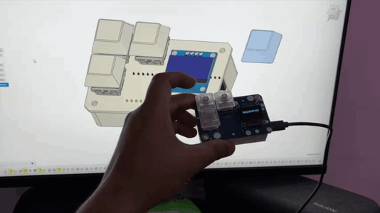

MACROPAD Pi is a three-button Macropad built from scratch and powered by the Raspberry Pi PICO. We're utilizing PICO as an HID device, adding three mechanical switches to it and an OLED screen to perform COPY PASTE and erase commands.
The idea here was to create a super small macropad that I could use while using Fusion360 and other software that required frequent use of the COPY, PASTE, and DELETE commands. We have also incorporated an OLED screen to provide feedback on which command has been selected.

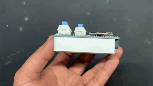

We prepared a PCB with a mechanical switch on one side and a display on the other. We set PICO on the bottom side of the board.

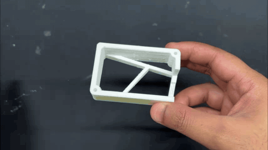

After completing this simple PCB model, we created the frame part that holds the circuit on top. This frame part has a little inclined bottom, allowing the circuit to be put at an angle and lightly tilted as a keyboard.
Frame part was finalized and 3D printed with PLA using a 0.4mm nozzle and 0.2mm layer height.

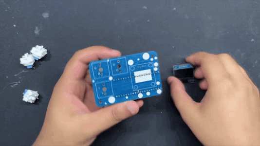

Step 2: PCB Design
For the schematic of this project, we initially created a small setup consisting of a Raspberry Pi Pico, an SSD1306 OLED screen, and three mechanical switches. We connected the OLED's VCC to the PICO's VBUS pin, GND to GND, the SDA pin to GPIO4, and the SCL pin to GPIO 5. All three switches are connected to GPIO0, GPIO1, and GPIO2.
Using the dimensions from the cad file, we created the PCB layout and the board outline and placed components in their proper locations. PICO 2 is located at the bottom of the board.

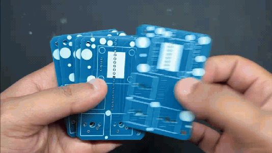

Step 3: NextPCB PCB Service
Gerber Data was sent to HQ NextPCB, and an order was place for Blue Soldermask and white silkscreen.
After placing the order, the PCBs were received within a week, and the PCB quality was pretty great.

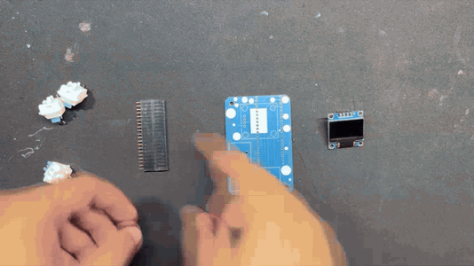

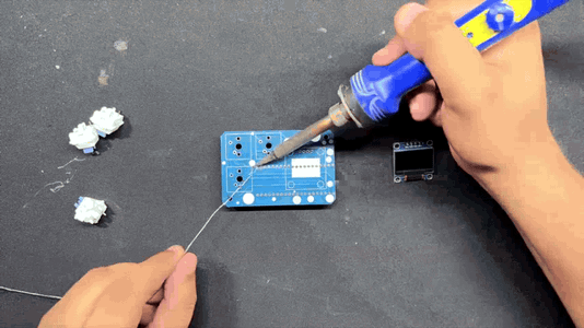

Step 5: PCB ASSEMBLY

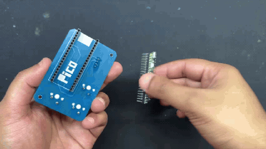

  1. We start the PCB assembly process by connecting the two CON20 female header pins on PICO's Footprint from the bottom side of the board.
  2. Turning the board over, we use a soldering iron to solder the connector pads from the top side.
  3. Next, from the top side of the PCB, we place the SSD1306 OLED, followed by the three mechanical switches.
  4. We solder the switch and OLED pins from the bottom of the PCB.
  5. Finally, we install the PICO over the CON20 Header pin connectors.
The PCB assembly has been completed.

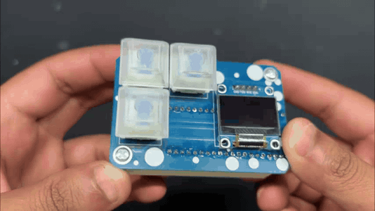

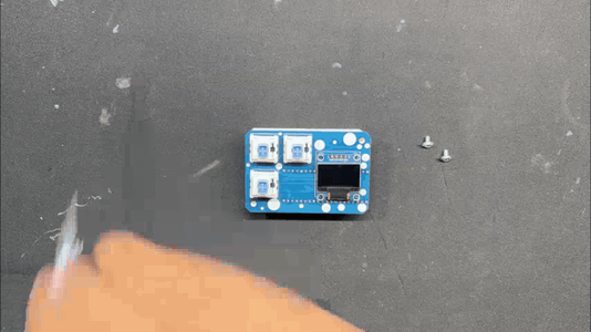

Step 6: FINAL ASSEMBLY
After completing the PCB assembly, we begin the final assembly process, which begins with placing the Circuit over the 3D printed frame and then securing both of them with two M2 screws each.
We added keycaps over the mechanical switches as a finishing touch, which completed the assembly process.

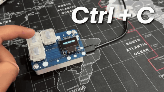

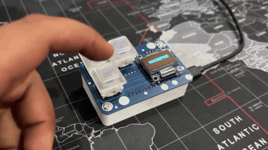

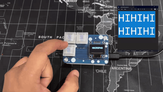

Step 8: RESULT
This tiny yet practical build culminated in a macropad capable of performing copy, paste, and delete commands. When you push the copy button, the OLED screen will confirm your action. The paste button allows for seamless pasting, while the delete button provides instant removal functionality. Simple, efficient, and designed for simplified input.

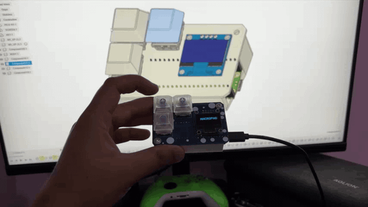

Using this Macropad, I was able to use my preferred design software, Fusion 360, without having to press the Control plus C button; instead, I simply pressed one button to copy and another to paste, and things became slightly easier.
Overall, this project is completed and requires no revisions.
