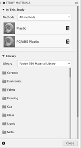

Specify the material. Since I am going to use PLA filament to print it out, I chose Plastic PC/ABS Plastic as the material.
