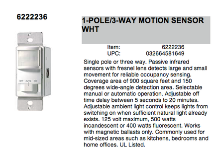

MATERIALS :
(1) 2 Gang Electrical Box
(1) 1-Pole /3 way Motion Sensor
(1) Receptacle
(1) Cover Plate to fit receptacle and Sensor
(1) Industrial grade power cord / pig tail,  cord connector / grommet.
(4) Wire Nuts
