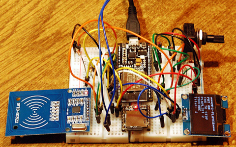

It's been a while that I have one Christmas raffle with RFID tags programmed for the ESP32. The contribution with the Speech output of measurement results back. I recorded the scraps of language with my cell phone and transferred to an SD card. Now you could of course also save music pieces on the SD card and call up via RFID tags-an MP3 player with expansion potential is ready. I tried various approaches for programming. What initially looked promising and interesting, an approach with threading, finally had to be abandoned in favor of conventional programming By grinding because the performance did not meet my ideas. I am now introducing this solution to you with the new post from the series
Step 1: MP3 Player With RFID
Strictly speaking, I came up with the idea of ​​this post through the articles on the subject of serial interfaces on ESP32/ESP8266 dem Raspberry Pi Pico and that PC. I wanted to show some other applications on the RS232 ports. Well, the DFPlayer Mini, which is used here, is controlled via the serial interface. And because a bidirectional data exchange is used, only one ESP32 or a Raspberry Pi Pico as a controller. A PC would also be able to parlice directly with a DFPlayer Mini via an RS232 TTL converter, but I leave that out. We have already arrived at the hardware list.
The assembly on two mini-breakboards looks through the many jumper cables bird game. After all, four interfaces are used, SPI (RFID reader), I2C (OLED display), RS232 (DFPlayer Mini) and ADC (Poti).
illustration 1: MP3 player - structure with SH1106
There are a few things to consider. The DFPlayer Mini must be supplied with 5V. Therefore, impulses with a level of 5V are also on his PIN TX, as is the busy pin. Because the ESP32 can only tolerate 3.3V to its GPIOs, the levels must be reduced By voltage divisors. I chose 1kΩ and 2.2kΩ. You can also take other values ​​that are in a ratio of 1: 2. Conversely, the DFPlayer at the RX input copes well with the 3.3V signals from the ESP32.
If the speakers are placed on GND with the black line, the 5V circle flows into electricity of approx. 450mA! This is because the connections SP1 and SP2 lead 5V level. Therefore, only connect the two speakers to SP1 and SP2, not to GND. Even if you only use one speaker, its lines belong on SP1 and SP2 (in Figure 2 yellow). Otherwise you would have to connect the speakers via an ELKO.
illustration 2: DFPlayer Mini with 4 GB SD card
The ADC input on the ESP32 can process tensions up to 2.4V. However, the potentiometer is 3.3V. Therefore, I reduce the offset voltage By counting a resistance of 2.2kΩ. So that the potentiometer can be put on the Breadboard, I have provided the connections with a 5-pin pen strip.
illustration 3: Poti with pen strip for the Bread Board Montage
You have to be particularly careful with the displays mentioned. The connections for SDA and SCK agree, but the pins for +VCC and GND with the 96 "module (pen strip above) are exchanged against each other in the 1.3" module (pen bar below). I used a 1.3 "module in the circuit of Figure 4.
illustration 4: SH1106 in operation
illustration 5: MP3 player - circuit
For autonomous operation, I have provided a battery owner for a Li-ion battery of the 16850. It can be connected directly to the ESP32 with the enclosed cable, which then takes over the supply of the other modules.
illustration 6: Battery owner 18650
The connection plan may be helpful for placing the circuit together.
illustration 7: Connecting plan
An ESP32 takes over the chief position. For its use, two Breadboards are required, which are connected to a power rail in the middle, so that you can get there with the intervals of the pin rows and cable can also be inserted on the edge.
The little brother of the ESP32, the ESP8266, is unsuitable for our purpose, because it cannot offer a second, full uart interface, and we need it to control the DFPlayer.

The selection of the playlists is made in this project By RFID The selection of the playlists is made in this project By data.The selection of the playlists is made in this project By reading the ID on the map. However, this clearly goes beyond the scope of this article and could perhaps be the subject of another blog sequence. Based on the ID, an 8-digit hexadecimal number, the ESP32 can instruct the DFPlayer Mini to play the MP3 files from a folder on the SD card. Order name and number are displayed on the Display together with the title number. User instructions are also shown in the Display.
The RFID reader
Due to the SPI bus, the wiring is also more complex than the I2C bus with its 2 lines alone. SPI bus devices do not have a hardware device address, but they have a chip-select connection (CS), which must be on low if the device is to be addressed. The data transfer also works a little differently, it is always sent and received at the same time. Clarifying the closer procedure is not necessary here, because the class Mfrc522 does that for us. We will only inform the constructor the follow -up assignments and the transmission speed. The transfer works with a fleet 3.2MHz. For comparison, I2C works to up to 400kHz.
Our own function readuid() reads the clear identification of a card and returns it as a decimal number and as a hexadecimal dial. The cards are requested via the OLED display. So that the function does not block the entire process, a timeout ensures an orderly withdrawal. In this case, the value None is returned instead of the card ID.
So that the playlist cards come into play, we need a master card. To do this, we take any card or a chip out of the stack, read the ID and thus prove the variable with the decimal value right at the start of the program, here:
Masteride = 4217116188.
At the first start, the ESP32 notes that there is still no file with the Playlist cards data and requires the master card. After this has been recognized, a playlist card is requested. After reading the ID, it is written in the file and the master card is requested again. Reading is continued until the last playlist card. If no playlist card is offered for 10 seconds after the request for the master card, the detection process is ended and the main program starts. To start completely from the front, we can slavecards.txt Delete with the Playlist card IDs via the Thonny-Console. The file can of course also be edited in the Thonny editor window.

while not allRead():
if addUID(d):
allRead=TimeOutMs(10000)
d.clearFT(0,3,15,4,False)
d.writeAt(" ALL CARDS READ",0,3)
cards=readTags()
If the list is not empty, it goes into the main loop that is constantly going through, even while a title is played.
IF Cards:
d.writeAt("***MP3-PLAYER***",0,0,False)
d.writeAt("PUT ON MP3-TAG",0,1,False)
d.writeAt("Hole die Anzahl",0,2,False)
d.writeAt("Songs/Folder",0,3)
filesInFolder=getNumberOfTitels()
d.clearFT(0,2,15)
df.stop()
while 1:
uid=readUID(d,"PLAYLIST-TAG",1000)
if uid is not None:
ncard=uid[1]
volume=int(vol.read()*100/1024)
df.volume(volume)
We try to read a card. If that worked, we show the hex string of the variables Ncard To and ask the potentiometer next.
The playing process of a new playlist is started when the content of acard not with that of Ncard matches. In this case will be acard already brought up to date.
if acard != ncard:
acard=ncard
Then we check whether the ID in the list cards is included. If so, we determine the index of the entry and have found the number of the folder on the SD card. We hand over the organization to play the playlist player(). She gets the reference to the OLED object, the folder number and the number of titles on the way.
if acard in cards:
d.clearFT(0,2,15,5, False)
t=cards.index(acard) # Ordnernummer
d.writeAt("PLAYLIST {}".format(t),0,3,False)
d.writeAt(listen[t],0,4)
player(d,t,filesInFolder[t])
The card ID was not in cards Found, we get an error message before going to the next round of the Mainloop.
For an autonomous company, without connection to the PC, the program must be under the name main.py are uploaded to the flash of the ESP32. The process is described above. Alternatively, you can also in Thonny Save AS from the File-Menu call up. Then choose the destination Micropython Device. If you now infect the ESP32 on the battery board, the program starts without a PC.
We are at the end with the meeting. There are other options for the equipment of the player. If you want it louder, put an amplifier on the stereo outputs of the DFPlayer Mini. With a few buttons you could scroll in the titles and with a WLAN connection you can take over the full control with an Android app that is easy with the MIT App-Inventor 2 can be created.
As a purpose for the player, all situations in which one would like to restrict or control the play program By the cards that are handed over. Wenn die Karten in eine Schautafel eingebaut werden, kann durch Auflegen des Players ein entsprechender Informationstext abgespielt werden. Or let the Teddibär tell different good night stories ...
Have fun tinkering, programming and implementing many other ideas.
