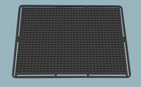

Step 1: Lasercutting
Use a 3 mm black ABS plate to create the grid and the components.
Cut each component 5 times and the grid once.

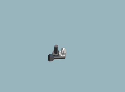

Four of the five components have a slot to put the plastic strips through. The fifth component is a small foot to make sure the robot can stand upright.

Nuts and bolts are used to connect the laser cut components to the grid. Place the components in such a way that a strip can be slid through them. Develop your own design. Be creative!
