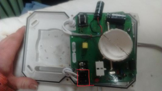

Step 1: 1. Remove the Plastic Casing of the Firealarm by Removing the Screws From the Back
-Use a phillips screw driver to remove all the screws from the back of the fire alarm
{there may be a little glue around the edges if so just pry open- it wont hurt the fire alarm)
Step 2: Remove the Speaker
2. Cut the wires from the round speaker that are going to the board from the speaker next to the board {the speaker is not used}- leave enough wire going to the board that you can hot glue the ends to avoid any contact with anything
Step 3: Remove the Screws Holding the Greenboard Down
Use a phillips screw driver to remove the screws holding the green board down to the back of the fire alarm plastic casing
Step 4: Removing the Original Capacitors
There are 2 capacitors next to the strobe light, remove them with a soldering gun and solder sucker if needed to get all the solder off the board
Step 5: Replace With Photo Flash Capacitors
using your solder iron, solder the two photo flash the capacitors where you removed the original 2, make sure that the - and + ends are soldered into the right spot on the board.
Step 6: In-series Wiring to Leads to Coil
Using a small pair of wire cutters cut the wire in the middle of the wire of the positive side of the strobe light if the wire that connects the light to the board
connect 2 leads to the wire going to the light and the wire still connected to the board long enough to go out of the fire alarm box where you took the speaker out of. , then connect the 2 4 ft leads onto the two leads coming off the light and board and bring out threw the box where the speaker was located
solder the leads and make sure that they are connected securely so they will not short out and make sure that the connections are covered with shrink wrap or electrical tape to avoid and contact with the board.
Step 7: Power Supply
connect the power supply to the right screws on the right side of the board labeled horn-strobe
