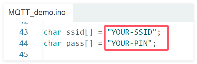

//The name and password of the connected WiFi network.
char ssid[] = "YOUR-SSID";
char pass[] = "YOUR-PIN";

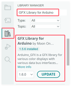

  3. Install the library according to the following version.
  4. GFX Library for Arduino v1.5.6

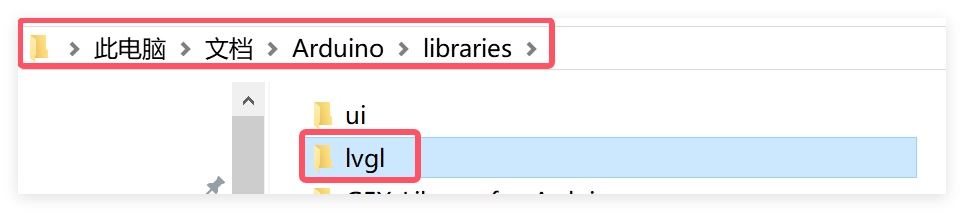

  7. Download and copy the lvgl library into the arduino library.(Usually located at C:\Users\Username\Documents\Arduino\libraries)

  2. Modify your WiFi name and password in the code.

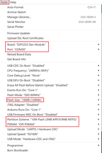

  3. Use Type-C USB cable to connect the board and PC, and select the development board "ESP32S3 Dev Module" and the port.
  4. Select "Tools > board:"xxx" > ESP32 Arduino > ESP32S3 Dev Module".
  5. Select "Tools > Port", Select the port number of the board.
  6. Select Flash Size is 16MB(128MB), Partition Scheme is 16M Flash (3MB APP/9.9MB FATFS), PSRAM is OPI PSRAM.
