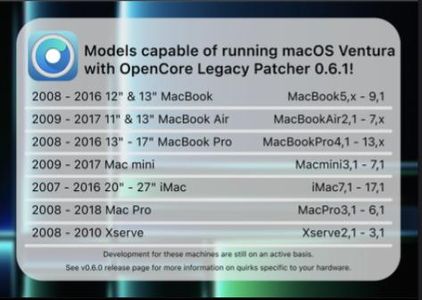

Step 1: Can You Patch It on Yours?
look at the picture and see if you’re Mac falls into the supported patching year range.
