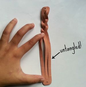

Step 5: Braiding (Part-2)
Now, lets start braiding again.
  • Left over middle - 4,
  • Right over middle - 5,
  • And Left over middle - 6, stop braiding.
Again, notice the gap on the left side, below the 6th braid. Take the other end through the gap and the strand are tangle free!
N.B.: If you start to braid from the right side, after crossing the 3rd strand pass the other end through the gap on the right side. similarly, if you start braiding from the left side, after crossing the 6th strand pass the other end through the gap on the left side.
Continue this process until you reach the other end.
You can keep the braid loose or tight as you want.
After you're done braiding keep something heavy over the braided leather strip for half an hour to give the braid a fresh look.
