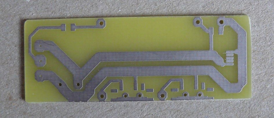

The PCB shown here is optional. The same outcome could be delivered by hard wiring pretty well any Arduino. In addition to the Arduino and the LED string Adafruit recommend adding a 1000uf capacitor (6.3v or greater) to the power lines to the string. They also recommend a resistor of around 330 ohms in series with the data connection. This provides some protection if the string is not powered up with the Arduino. Note that the power to the string must be provided directly. Arduinos are unlikely to be able to deliver the current required. Many have fuses and/or diodes in their supplies. I considered using a Nano or a Leonardo but neither can deliver the current required from their 5v lines.
The circuit board adds these components, and a micro USB socket, plus a couple of switches and holds an Arduino Pro Mini. I got the components on ebay. The switches are sold as 'SMD Switch 7mm x 3mm'. See photo below as double check:
My approach to PCB making is to print the artwork twice onto tracing paper. I then overlay these to double the contrast and cover any small imperfections in the printing (I use a laser printer). I punch holes in the edge of the upper layer, place Sellotape across the holes, align and then press on the holes to stick. I have a UV exposure unit. I used to use a UV black light that worked fine with spray coated PCBs and should work fine with positive photoresist boards. I use weak sodium hydroxide solution (drain cleaner) to develop and Di-Sodium Peroxodisulphate Hexahydrate to etch. Take special precautions with the chemicals, especially the sodium hydroxide that attacks flesh instantly. I then expose again and develop to get rid of the film over the tracks and finish off with some immerse tin (quite expensive – and limited life). The latter step is optional.
The switch locating holes are 0.7mm, the capacitor 0.7 or 0.8mm, holes to the Arduino 0.7 to 0.9mm (use latter if using pinstrip pins to connect), holes for leads to the Led strip 1.2mm.

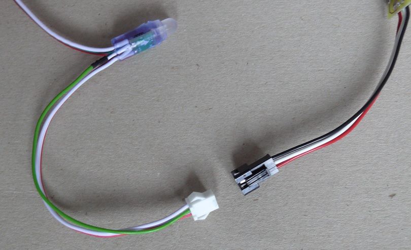

Take care when wiring to the LED strip. See black, white and red wires above for ground, data and 5v.
The WS2811 LED string came with a 2 pin connector and a 2 wire lead. The former is the data and ground and the latter the power. Check by looking at the labels on the LED circuit board, and make sure you are connecting the data wire to DI rather than DO.
The WS2812 LED strip came with a 3 pin JST SM connector. This is rated at 3A and seemed like a good standard to use. I got some more of these from Farnell, codes as below. These are also available on ebay.
pins3357661
pin header3357739
sockets3357673
socket header3357697
I removed the data and ground lead and soldered a data wire to the 3 pin JST connector:
I also trimmed the leads at the far end as I didn't see my extending the length. The voltage drop is pretty high and adding second string would need a fresh power connection.

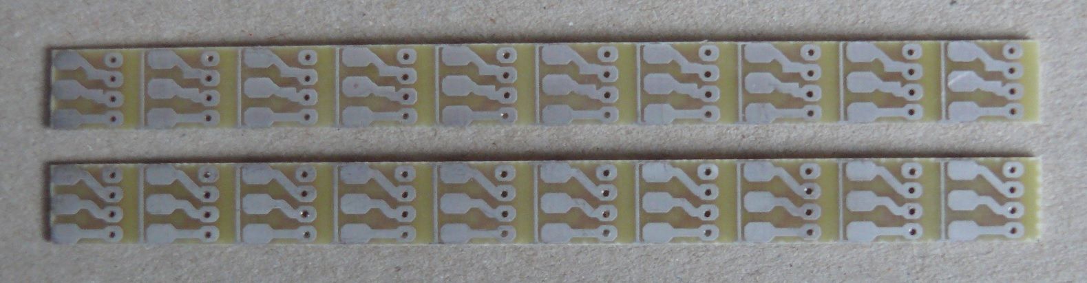

The PL9823 LEDs look like standard RGB LEDs but also include a LED controller similar to the WS2812 LEDs. They come in 5mm and 8mm sizes. I used the latter. The 4 wires are data in, positive, ground and data out, with the latter next to the flat on the package.
I designed an 8x10mm double sided circuit board to mount this and to connect to the incoming and outgoing power and data wires. I did the artwork for 10 off to make the etching a bit easier. I have attached the artwork. The input side of the board also holds a 0.1uF 0805 capacitor. There is no harm including this when the data is flying around at 0.8 Mhz.
After making the boards and drilling the holes at 0.8mm I cut them into separate boards and added the capacitor.
