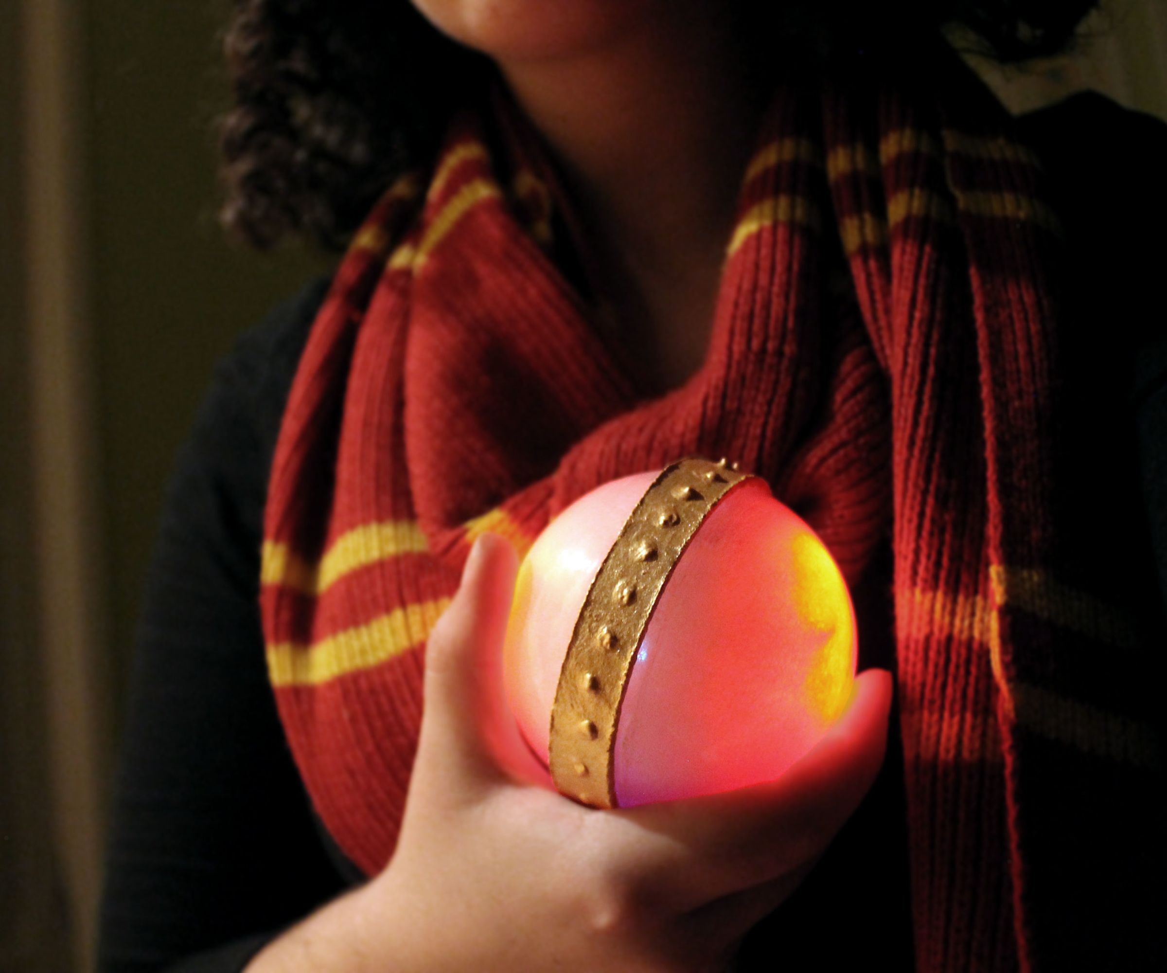

Introduction: Magic Wand TV Remote
One night about a month or so ago, I was watching an episode of The Big Bang Theory. In this particular episode, Howard and Raj were controlling their TV using a MAGIC WAND TV REMOTE!!!!!! Upon witnessing this sheer awesomeness, the preteen Harry Potter Fangirl inside of me had a minor heart attack.
Of course after seeing the episode, I did a quick google search to see if this Magic Wand TV Remote actually existed, and I came across the Kymera Wand. I was tempted to purchase this product, but decided against it. I had been wanting to learn how to work with Arduino for quite some time, so I decided that making my own Magic Wand TV Remote would be a great way to force myself to do just that.
In case you are not familiar with the Kymera Wand or the episode of The Big Bang Theory that I mentioned, a Magic Wand TV Remote functions without pressing any buttons. By waving the wand in different ways, different commands are sent to your television. I have programmed my Magic Wand TV Remote to turn the TV and cable on and off, control HDMI functions, and to turn volume and channels up and down.

Step 9: Download and Print the 3D Models
To house the electronics, you will need to download and print the included 3D models. I printed these models using both a raft and supports. When printing, the inside of the model(with the cutout rectangles) should be facing up so that the support material is on the outside of the model.
I printed these models on a Makerbot Replicator 2 3D printer. The files TopLong.stl and BottomLong.stl do not fit lengthwise on the build plate, but do fit diagonally across.
When you are done printing, remove the support material and you should be good to go!
Step 10: Glue Together BottomShort.stl and BottomLong.stl
Using the Elmer's Cement Glue (or equivalent), glue together the two models that you printed from the files BottomShort.stl and BottomLong.stl. To get a stronger adhesion, rough up the sides that need to be glued together using sandpaper.
Step 11: Solder Your Arduino Micro, MPU-6050 and Infrared LED
The next step is to solder your Arduino Micro and MPU-6050 using gauging wire to connect the pins. As I am not very experienced in soldering, I found this step to be extremely difficult. Luckily I found this great tutorial on Youtube which helped me quite a bit.
Make sure when soldering to use as little gauging wire as possible. The 3D printed parts do not have enough extra space to fit large amounts of extra wire. To make sure your Arduino and MPU-6050 fit properly, test them out by placing them inside their designated spots inside of your 3D printed parts as you solder.
To prepare to solder on the infrared led, you will want to cut two long pieces of gauging wire that each stretch from the end of the remote to their corresponding pins. When soldering on the Infrared LED, we want as little space between the LED and the end of the remote as possible. If you do this correctly, the LED should be centered with the hole on the end of the Magic Wand TV remote when gluing all the parts together.
Solder the gauging wire onto the correct pins and solder your 100Ω resistor onto the end of one of the pieces of gauging wire. Solder the cathode(+) onto the resistor and the anode(-) onto the other piece of gauging wire. It is a good idea to include heat shrink tubing around your anode to ensure that the two LED terminals don't accidentally touch.
Step 12: Solder Your Battery Holder and Slide Switch
To begin soldering your Battery Holder and Slide Switch to the Arduino, you will need to trim the wires on the battery holder to just span the length from the correct pin on the bottom of the Arduino to the hole cut out of the file TopLong.stl.
Begin by soldering the black wire to the GND pin. Next, solder the thered wire to any one of the corner pins on the Slide Switch. The slide switch that I purchased has 6 pins, 3 on each side. Cut a piece of gauging wire that can span from the Slide Switch to the bottom of the Arduino. Solder one end of the gauge wire to the center pin on the same side of the Slide Switch that you soldered the battery holder to. The other end of the gauge wire needs to be soldered to the VIN pin on the Arduino.
If you have soldered everything correctly, you should be able to use this switch to turn you Magic Wand TV Remote on and off.
Step 13: Insert Your M3 Nut Into the 3D Printed Part
Inside of the part you printed from the BottomShort.stl file, there is a hole that can fit an M3 nut. The fit is pretty snug so if you can't push the nut in with your fingers, grab a hammer or another small heavy object and give it a good whack! This should the nut to fit tightly within the hole.
Step 14: Glue It All Together!
Yay, you're almost done! The last thing you need to do is glue everything together.
All of the 3D printed parts need to be glued together except for the part printed from TopShort.stl. Since we have already glued two of the parts together, the only part we need to glue on is the one printed from TopLong.stl. Grab your Elmer's Model & Hobby Cement (or equivalent) and apply the glue to the edges of the parts that you want glued together. It is very easy for wires to pop out while gluing, so make sure you are being patient and looking out for anything not in place. All of the components fit very tightly within the 3D printed model so the parts have a tendency to want to separate. Apply pressure to the pieces by squeezing them together with your hands while they are drying.
Also, make sure your Slide Switch is popping through it's designated hole. Adding a little bit of glue will help the slide switch to stay in place as well. I found it was easier to apply to glue to a thin object which I could use to brush the glue between the slide switch and the 3D printed part. I found a spare piece of PLA filament to use, but anything thin such as a toothpick, end of a paint brush or Q-tip would work.
Lastly, pop your 3D printed part from the file TopShort.stl in place and secure it with an M3 screw.
Step 15: Blimey, You're Done!!!!!!!!!
Woohoo! You've made a Magic Wand TV Remote! 10 points for Gryffindor!!!!!!!!
Go call your friends, show them your remote and watch them be amazed! Most people who I've explained this project to either think I'm the coolest person they know.....or the strangest. If you make this remote, you will probably get similar reactions.
Hope you enjoyed!
