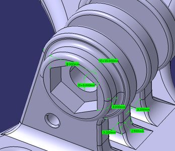

Couple of things to take in consideration:
Weight/Strength:
  • Remove material where not needed - drill holes, fillet edges
  • Use rounded shapes (sharp shapes = high pressure & strain)
  • Make section/shapes change as progressive as possible
  • Model an hollow shape with link/reinforcements between surfaces - (think how hard it is to crush a soda can)
Mounting stability:
  • Consider 3 set of legs for it to be stable (3 point define a plane - 4th or 5th one might not be on it)
  • try to put opposing magnets as close a possible (the closer they are the stronger they pull)
  • elevate the center of your bracket so you can mount it on slightly curved surfaces
  • design the back mount so it covers the biggest area possible but don't make it too big either (surfaces sticking out too much might offer a big leverage and separate more easily)
Drops and crashes:
  • Rounded edges will prevent the mount to pinch and tear fabrics on impacts
  • If you think there is a chance for the mount to loose its grip - plan holes to tie up a leach.
Printing restriction:
As always keep in mind the minimum wall thickness and other size of free standing walls.

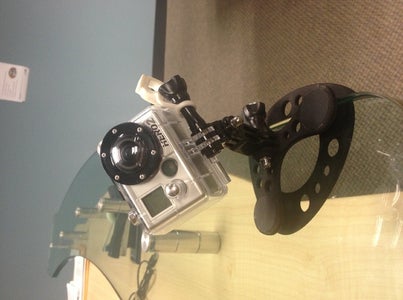

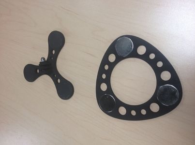

See pictures for basic mount dimension.
The overall size of this first design is about the size of a CD. (had to fit in a paraglider cell and under wetsuit)

Glue all magnets with he same orientation (North facing up for instance) for both mounts - test orientation BEFORE bonding.
I'd recommend flexible glue like Goop or 3M 5200 marine (nastiest toughest glue ever)
Epoxy or crazy glue will also work but might resist a bit less to strong impacts.
If weight is not an issue, you can fill up the mounts with glue to make them even more resilient.
In my case I printed extra caps to hide the magnet on the top mount.
Snap both part together and let it dry .This will insure your magnet are correctly oriented and squeeze away the exes of glue in between - remember the close the magnets are the better!)

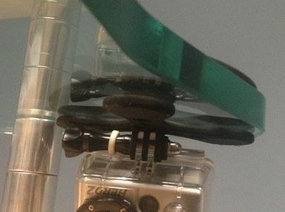

The magnets will come a bit more easily apart by twisting or sliding them.
Utilization : (tested with low magnetic grade N40)

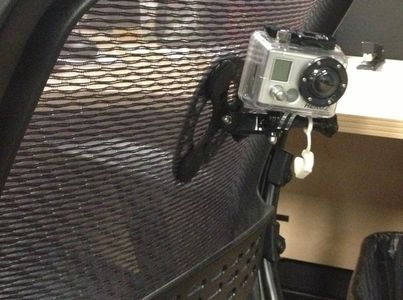

Dynamic (Shocks &Vibrations) - material up to1/4in thk (tshirt, kite, paraglider, car window...)
Static - material up to 1in thk (table,doors, drywall, ceiling, boat hull...)
