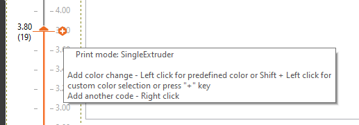

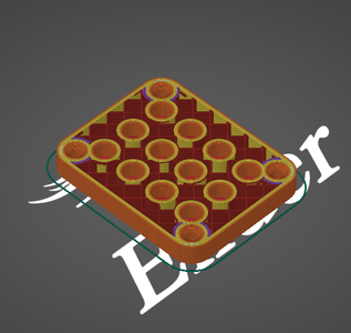

We will use the PrusaSlicer ColorSwitch to stop the print at the right point
Open PrusaSlicer and import the file. And click on the slice button. A timeline will appear on the right side of the screen. This shows the selected part of the object. Therefore, you can move this little triangles at the bottom and top of the timeline. You move the top triangle until you only see one layer above the holes. Now you click on the small + symbol. The program calculates the color switch, and you can see the result after 1 second.
