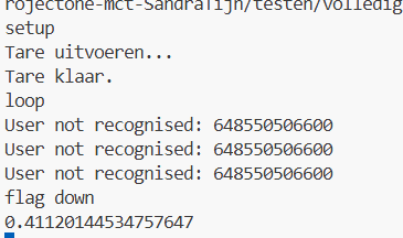

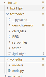

Step 5: Test Everything Out
To check if you wired everything up correctly, I included a test code in testen/volledig/code.py (2024-2025-projectone-mct-SandraTijn/testen/volledig/code.py at main · howest-mct/2024-2025-projectone-mct-SandraTijn). This will test the flag, lock and weight sensor, as well as the RFID sensor. The weight sensor will tare, then the lock will open and close, the flag goes up and down, and every 10s the weight sensor will output a value. This code will also help by giving the RFID-code of a tag it doesn't recognise, which you should copy and store somewhere to be put in the database.
Also, let's test out if Apache works. On your PC, and on the same network as the Pi, open a browser and paste the Pi's IP-address in the address bar (the big bar on top, not the search bar like on Google's start page). When everything is okay you should get a default Apache web page.

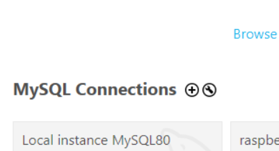

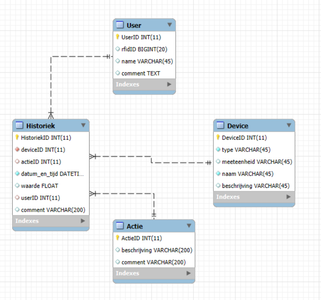

Step 6: The Database

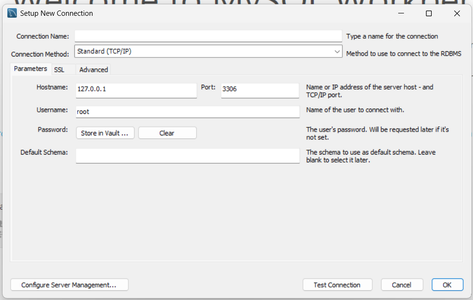

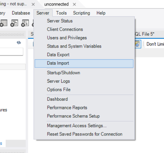

First you should make a connection from your PC to the database with MySQL Workbench (install it if you haven't already). Just open Workbench, and click the + next to "MySQL Connections". Then insert the Pi's IP adress, the username and password (you created this when you installed MySQL on the Pi).

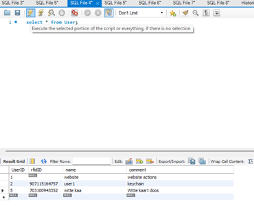

Then, download the dump folder from the "data" folder in the repository (2024-2025-projectone-mct-SandraTijn/data/Dump20250619 at main · howest-mct/2024-2025-projectone-mct-SandraTijn), and unzip it. Then in Workbench go to "Server", then click "Data import". Check "Import from Dump Projecct Folder", and select my folder. Then press import. It should now have created a database called "project_one" with the same tables and connections as in the picture.
Then select the database by double clicking it (the name should now be in bold text), and make a new script. Insert: "select * from User;" and execute using the lightning icon above it. It should now output users. You can delete all users, except the first (the website), and add your own using the RFID-ID from the tag, and a name of your choosing. Do mind that due to UI reasons (of the website), the name is limited to 9 characters. Don't forget to press "apply" at the bottom when you're done, and check by re-running the "select * from User;".

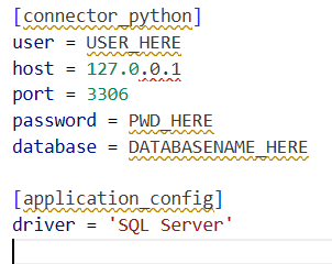

Now that we have wired everything up and made the database it's time we connect the two. In the "backend" folder there is a file named "config_example.py" (2024-2025-projectone-mct-SandraTijn/backend/config_example.py at main · howest-mct/2024-2025-projectone-mct-SandraTijn). Copy it, and rename it to "config.py" .
In this file, you'll change the "USER_HERE" at "user" to the user of the database, "PASSWORD_HERE" to the database password, and "DATABASENAME_HERE" to the name of the database ("project_one" if you haven't changed it). Don't use any apostrophes. It's normal that it gives an error, but just ignore them.

  3. Same for the user_ids, they get read from the database.

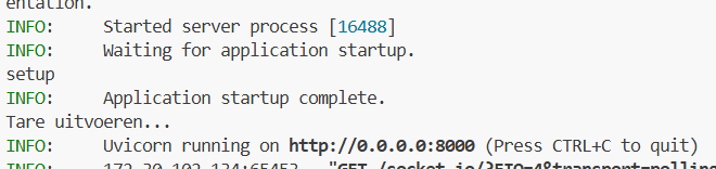

Step 10: Run the App.py
Now it's time to test the main code. Go to "backend", and run the app.py. If everything goes allright, it should give an output like in the picture, which says the backend is running correctly, as well as the lock, flag and LED testing again. If this is indeed happening, go to the IP address again, and now it should give you a website. If this is the case, congratulations: everything works!

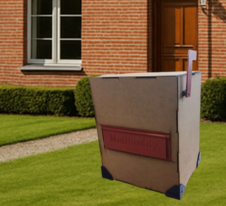

Step 12: Enclosure I (box)
Now we'll make the enclosure, so that we have an actual mailbox. I've included the files I used. There is an outside box, which is the outside, and an inside. The inside consists of 2 rectangles that fit inside, one at the bottom for the weight sensor (one side is screwed into the bottom, the other in the plate), the other is held up about 80mm from the top (but not glued) with some corner brackets (Thanks to Tez_Gelmir for his design: Internal Corner Bracket by Tez_Gelmir - Thingiverse . I only made it square inside, see later). This 80mm high area will be where the breadboard and Raspberry Pi are located, and the power cables can nicely fit throug the hole on the left side.
There are some problems with my SVGs tho. There are no holes for the lock or for cables to go through to the bottom, and neither are there holes in the bottom inner plate for the cables of the weight sensor. I didn't add these since I wasn't entirely sure how everything would be positioned. Luckily adding them is easy, just drill some some holes where the hole in the corner brackets are, and for the bottom plate just saw away the corners.
Lastly, print 4 more corner brackets and glue them to the bottom, since there are 2 screws from the weight sensor in the bottom. That's why I changed the brackets a bit to make them square inside.

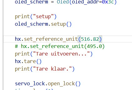

Step 13: Calibrate the Weight Sensor
When you're weight sensor is in place, it is time to calibrate it. Comment out the "hx.set_reference_unit(516.82)" line and run the code. Now place something you know the weight of on the scale, and write down the value you get.
Then, use the formula:
weight = raw_value / reference_unit
reference_unit = raw_value / weight
Now you should have a reference unit. Remove the comment of "hx.set_reference_unit(516.82)", and replace the value with your new reference unit.
