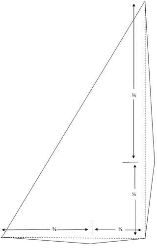

    If you cut the sail as in the pic it will make an airfoil shape and be more efficient. Just a thought, nice 'ible'.
