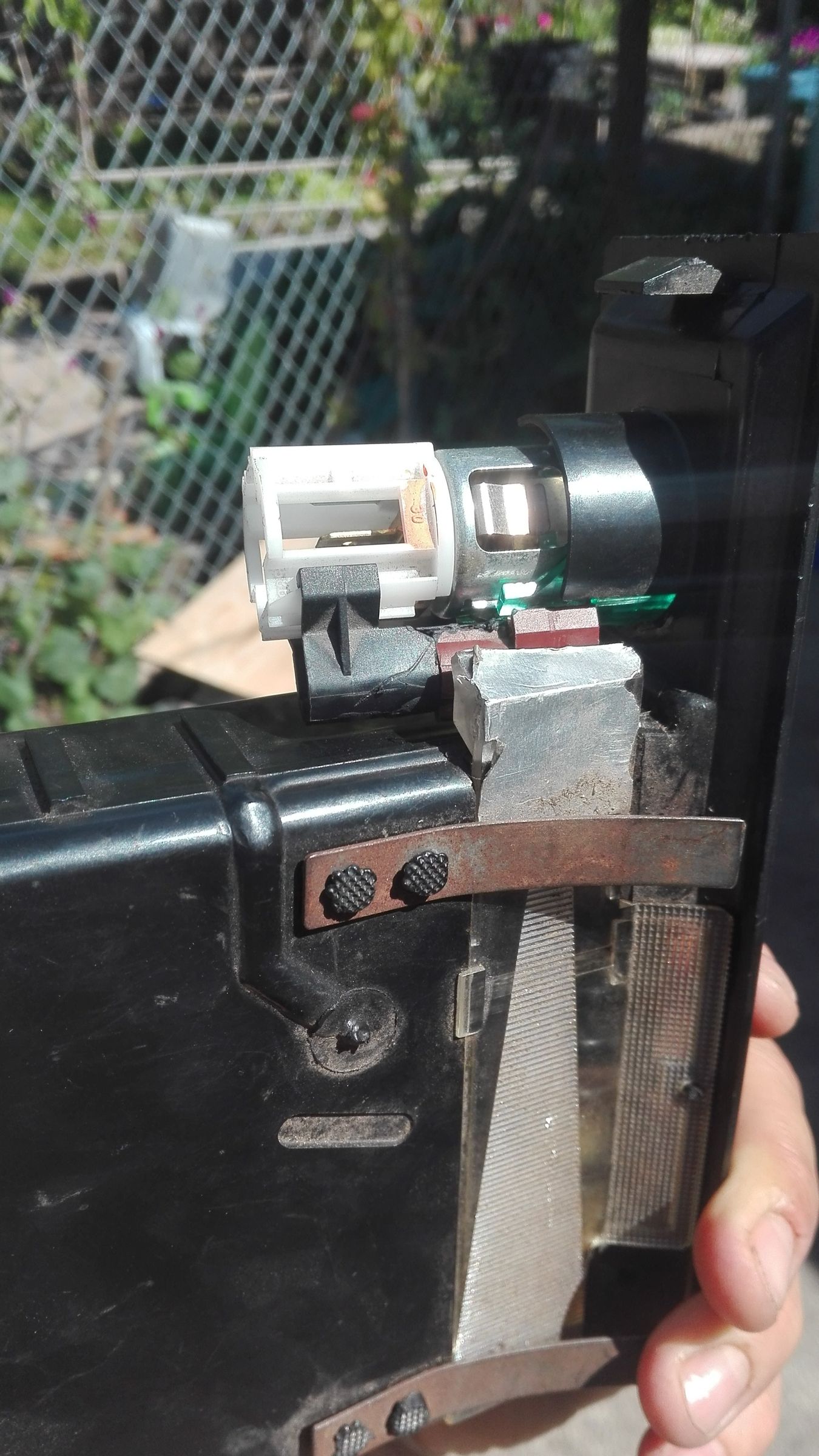

If it's true that soldering is probably the best option, It is also like the learning curve of driving a Motorcycle. If you live on a boat 10 months per year, you might considering other option in what to use for your end.
We want to connect a Strip of 4 flat cable to a USB [B] type male connector at 90 * angle to protect the Vintage Electronic Board, or any others.
A none extrusive HDMI adapter would be awesome.
