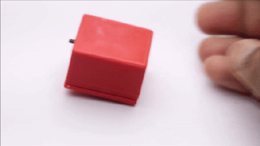

Hi readers in this project I made a 3D printed mini Bluetooth speaker that has powerful bass, The Bass is so powerful to its size that it can move the entire speaker when it is flipped upside down as you can see from the images.
The image shows the power of bass and now you can imagine what you can expect from this project!
I made this speaker so small to make it portable and fit any small pocket, The speaker is rechargeable and connects all your devices like mobiles, tablets, and computers.

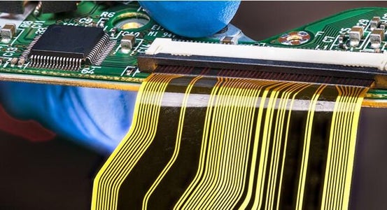

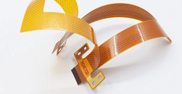

A revolutionary solution that combines the best of both rigid and flexible circuitry to elevate your electronic projects to new heights.
With their expertise in advanced manufacturing techniques, they offer a seamless integration of rigid and flexible components, ensuring enhanced reliability, durability, and space-saving benefits
Check Here for Rigid-flex Pcbs with this your circuit becomes flexible! i have added the images on this step kindly check
I bet you have not seen anywhere such assembly capabilities.

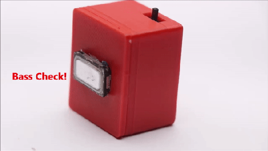

The electronic circuit has to be cased well so that the connections do not touch each other, This is made possible with the help of a 3D printed speaker case, Even though the model looks simple it is designed by keeping the electronic component sizes in mind.
The design I made occupies 100% of the space inside it! So you can say this is the least amount of size the speaker can have by considering the sizes of the components.
Start by placing the charging board at the bottom of the case, then the Bluetooth module upon the top of this I placed the sound amplifier board.
Once all these are kept in their place the speaker comes on the top and for this, we have to seal the top portion of the lid and later glue the speakers.
The final result of this step is shown in the last image, This almost completes our project and i cant wait to test this speaker.
