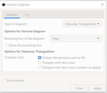

With just the circles selected, I clicked extensions>generate from path>voronoi diagram. Then, using the settings in the second picture, I created the voronoi diagram from those circles.

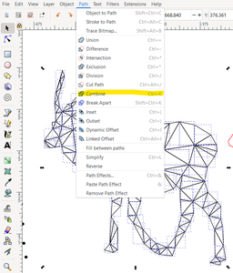

There were a lot of lines I didn't want, so I clicked on the new diagram and clicked ctrl+shift+g to ungroup the objects in the voronoi diagram. Then I clicked on every line I did not want and pressed delete to get rid of them. Finally, I got just the elk remaining.
I then select all the triangles of the elk and click path>combine so that all the triangles share their paths and become one shape.

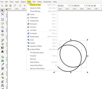

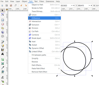

I made a quick moon by drawing two circles, overlapping them slightly, converting them to paths using path>object to path, then clicking path>difference.
I gave the moon stroke a gradient fill and placed it on the background.
