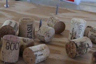

Oh well, it's a simple concept and I'm pretty sure I got it right. The picture I had showed seeds much closer together, but since my raised beds are only 4' wide, the 2' board will work well for us.They didn't actually have a detailed guide on making it, but it seemed fairly straightforward, so I took a 2' wide piece of plywood and we cut it
2' x 2', then I measured it into 2" grids. We used 3/4" wood screws at the 2" marks, and then screwed the wine corks that were cut into 1" length onto each screw. I just used a common box cutter to cut the corks into the correct length. I also cut 1/2" corks for another board that I'm going to make soon.
Step 2: NeXt Step.
I went into the house for the corks and by the time I got back out, Colleen had almost finished up putting in the screws! She works fast!I added a touch of liquid nail at the base of each screw just as an added guarantee that the corks would stay put.

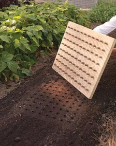

Step 3: Finaly Product.
Now I just need to add a couple of drawer pulls on the back side to use as I press the board into the ground to create the 1" indention into the soil for my seeds. I'll be using this on the 15th to plant the beans and squash plants!
