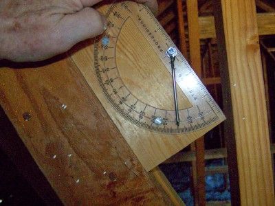

I always thought I wanted a precision angle finder. I finally decided to make my own. The photo shows it in use to check the angle of a rafter in my attic. This is a very easy project, but some precautions need to be followed to guarantee the accuracy of the tool when finished.

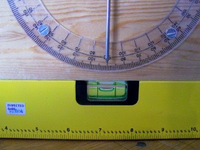

Does the angle indicator show "0" degrees when resting on a level surface? I used a level, but the surface was not level. So, I placed a thin wedge under the level until the bubble was centered between the lines. (See the first photo. I turned the level end for end to be certain it was reading accurately, too.)
See the second photo. The pointer is correctly calibrated. If the pointer did not read correctly, I could bend the nail just a little near its middle to get an accurate reading corresponding to the level.

The first photo shows the angle finder in use to read the angle of a rafter in my attic.
The commercial angle finder shown in step 1 is graduated with readings for 360 degrees. But, it does not have two parallel edges. I can place my angle finder under or over an angle to be measured. The first photo shows a reading taken from under that angle. The second photo shows a reading taken from above the angle. All you really need to know is how many degrees off of a horizontal or a vertical surface the angle is. The third photo shows the angle finder used with the side as the base for measuring a more vertical angle.
