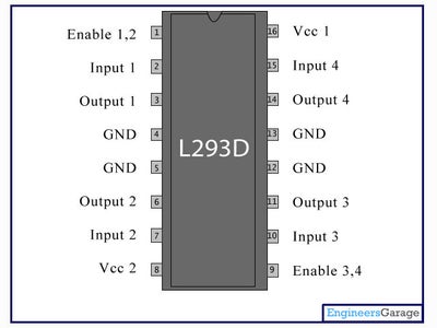

Step 3: Motor Driver and NRF24L01 Modules
Motor Driver
We will be using L293D as a motor driver because its easy for wiring and supports this motor
see the diagram connect the motors as given above if you want to get more information on L293D motor driver you can get more info on the below link i have learned from this.
www.instructables.com/id/Control-your-motors-with-L293D-and-Arduino/
