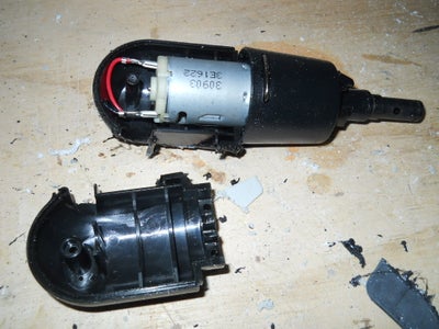

Step 3: Hacking the Electric Screwdriver
I took a Black & Decker electric screwdriver and I cut it in two separated parts: the gearbox (for the pincer open and close movement) and the handle (for grabing the cyborg arm and actuate the gearbox).

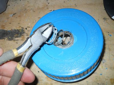

I grabbed the Thermo's cap and removed the center pieces. Then I made a big hole for gitting the gearbox, attaching it in the center with small corner braces.

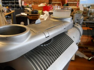

Step 9: The Cupholder
The plastic culpholder from the stroller have two functions: beverages holder and box for the batteries holder. So I attached it to the cyborg arm, and installed the batteries holder inside the cupholder box.
I attached one pillar from a baby table, giving a bulky aspect to the arm.
Step 10: Painting
I sandpapered the cyborg arm and then painted it with Krylon Stainless Steel Finish.

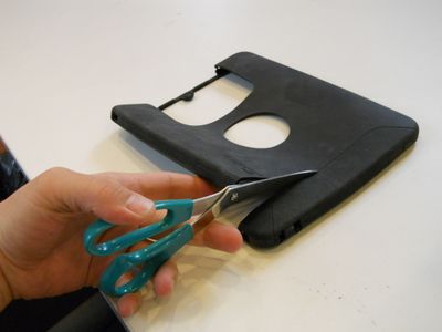

When the paint dried, I made two pads for the pincers, cutting pieces from a damaged tablet case. I attached some black plastic pieces too, for a better contrast with the steel paint.
