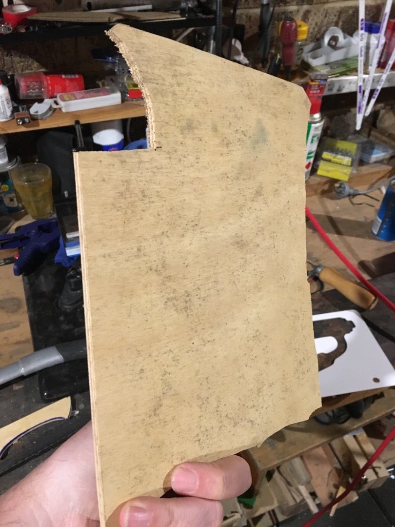

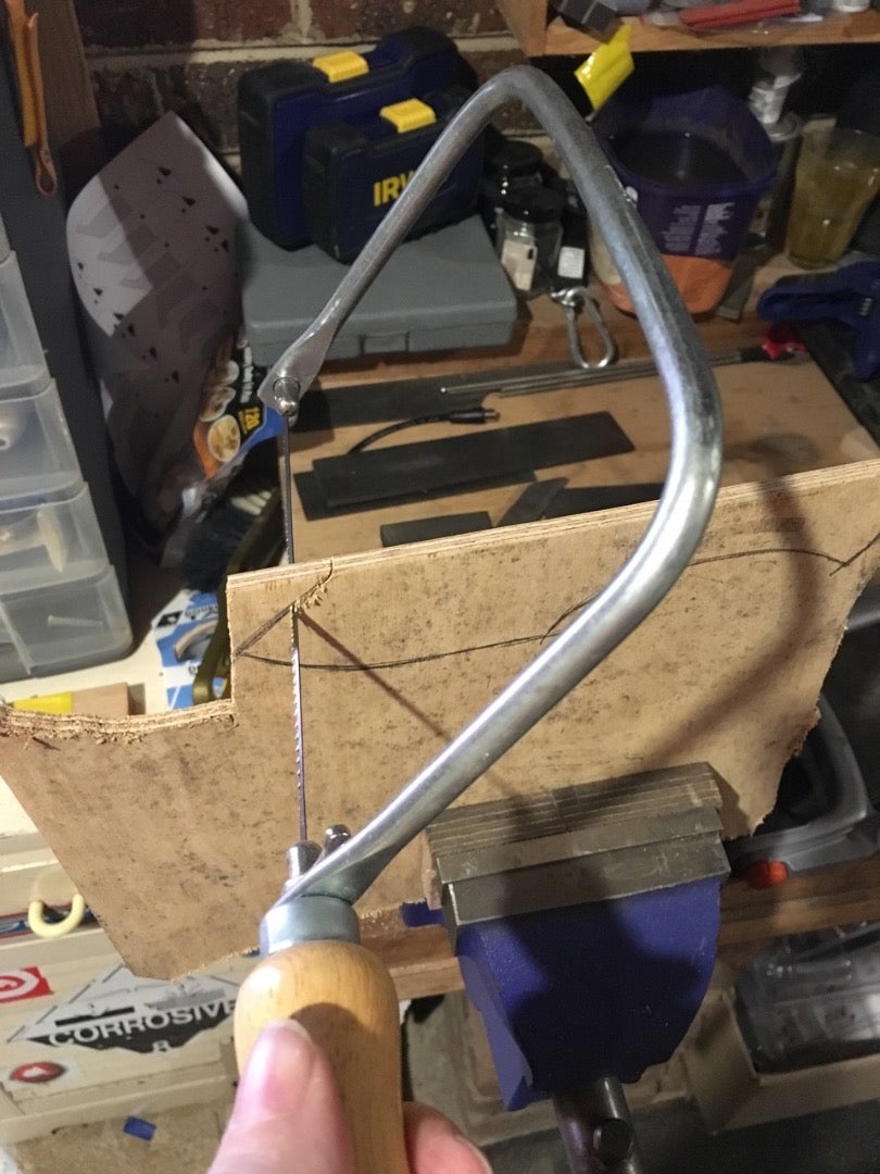

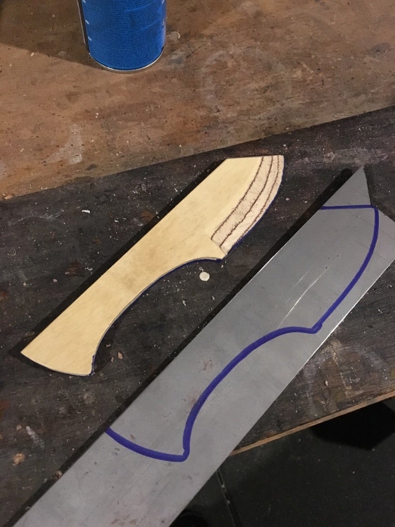

I find it very useful to make a wooden template first to get a feel for how the knife looks at the actual size, how it feels in the hand and to refine it from there if necessary.
Using a scrap piece of plywood, sketch (or trace, or print on paper and stick down) your design.
Get out a coping saw, or other thin-bladed saw and cut it out. It will save you a lot of time doing this with wood, rather than trying to refine and tweak the shape once you've cut it out of metal later on.
Once it's cut out, sand down the edges and see how it feels to hold it in your hand.
Step 2: Refine the Template

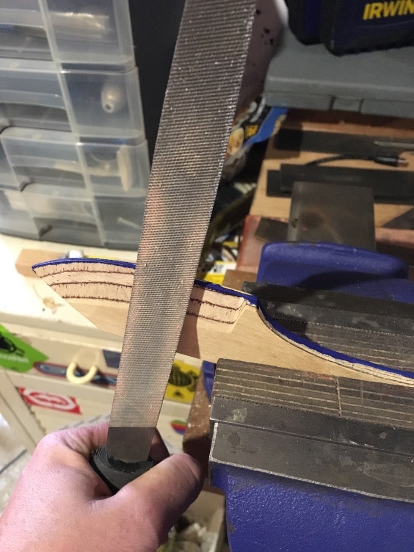

I'm going to go with a Chisel Grind on this blade (ground on one side and flat on the other side) just to see how it goes. This is my second time grinding bevels on a blade and I want to concentrate on getting the bevels as straight as possible and don't want to have to worry about having them symmetrical on both sides.

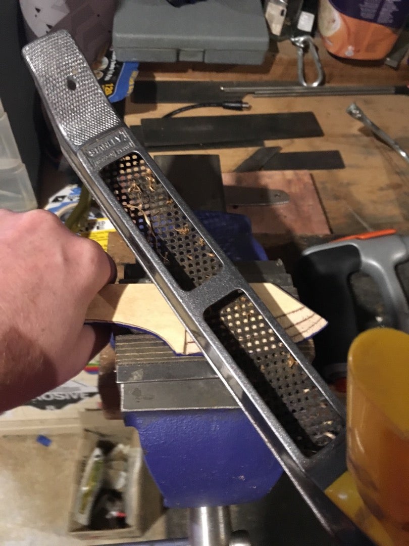

I've roughed out the bevels on the wooden blade to once again see how it is going to go. You can use a rasp, files, sandpaper or a grinder to do this - it's pretty quick and easy.

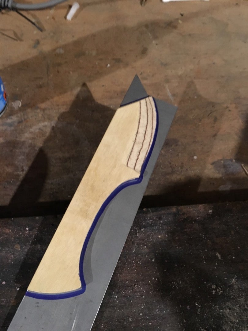

Step 4: Trace the Template on to the Steel

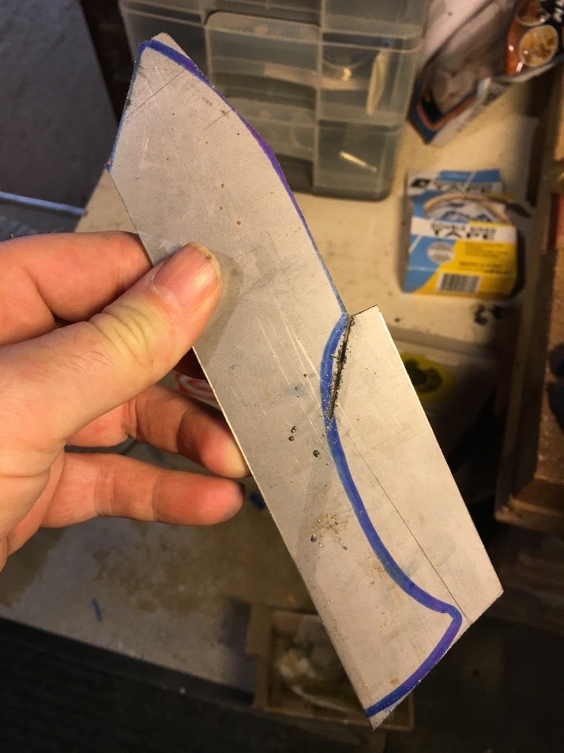

I have just used a permanent marker to trace the template onto the steel. If you have layout dye or anything like that, feel free to use it. As I've traced around the edge of my template, if I want to make the knife exactly the same size and shape I'm cutting or grinding to the inside of the line.

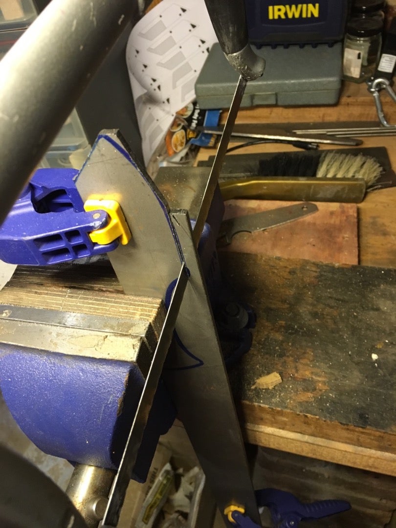

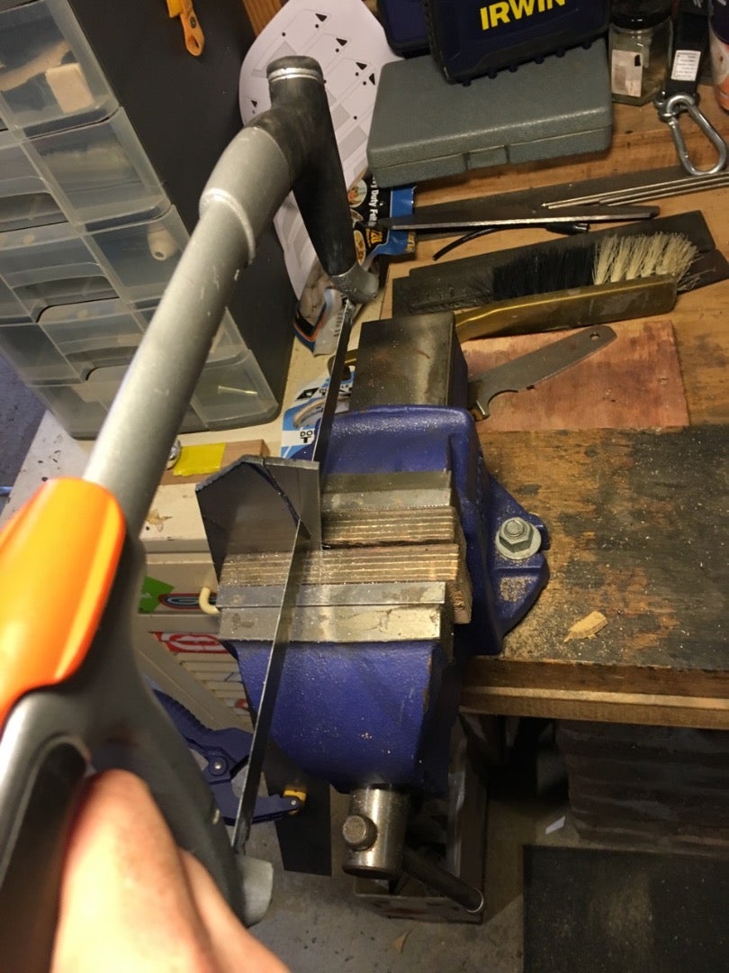

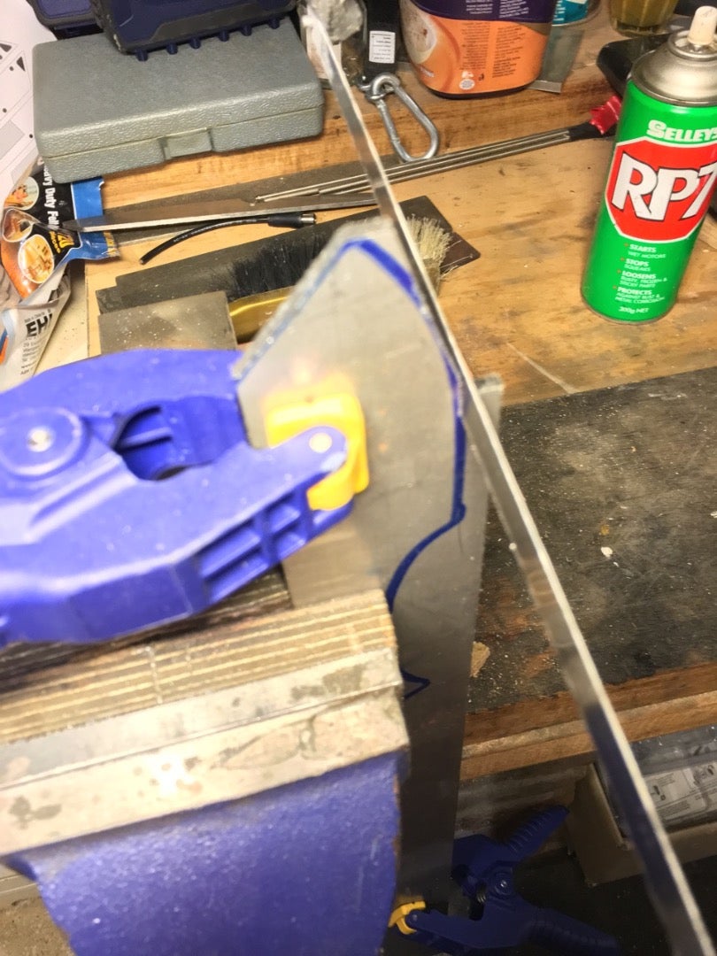

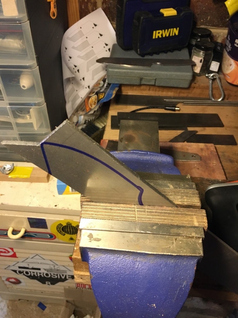

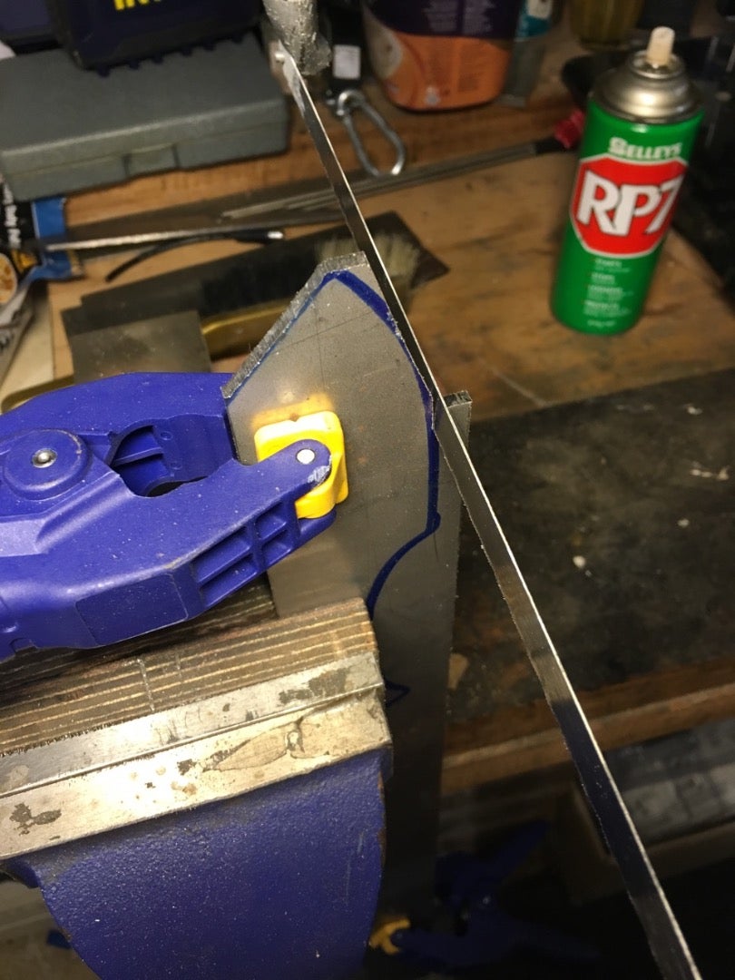

Step 5: Get Out the Hacksaw and Start Cutting
If you have access to a bandsaw or other powered cutting tool, feel free to use it to speed up this step. You can also use an angle grinder with a cutting wheel if you want. If you are using an angle grinder, make sure you've got a cutting wheel, not a grinding wheel - they are made differently and I don't want you to use the wrong one and have it come apart at 10,000 rpm in your hands.

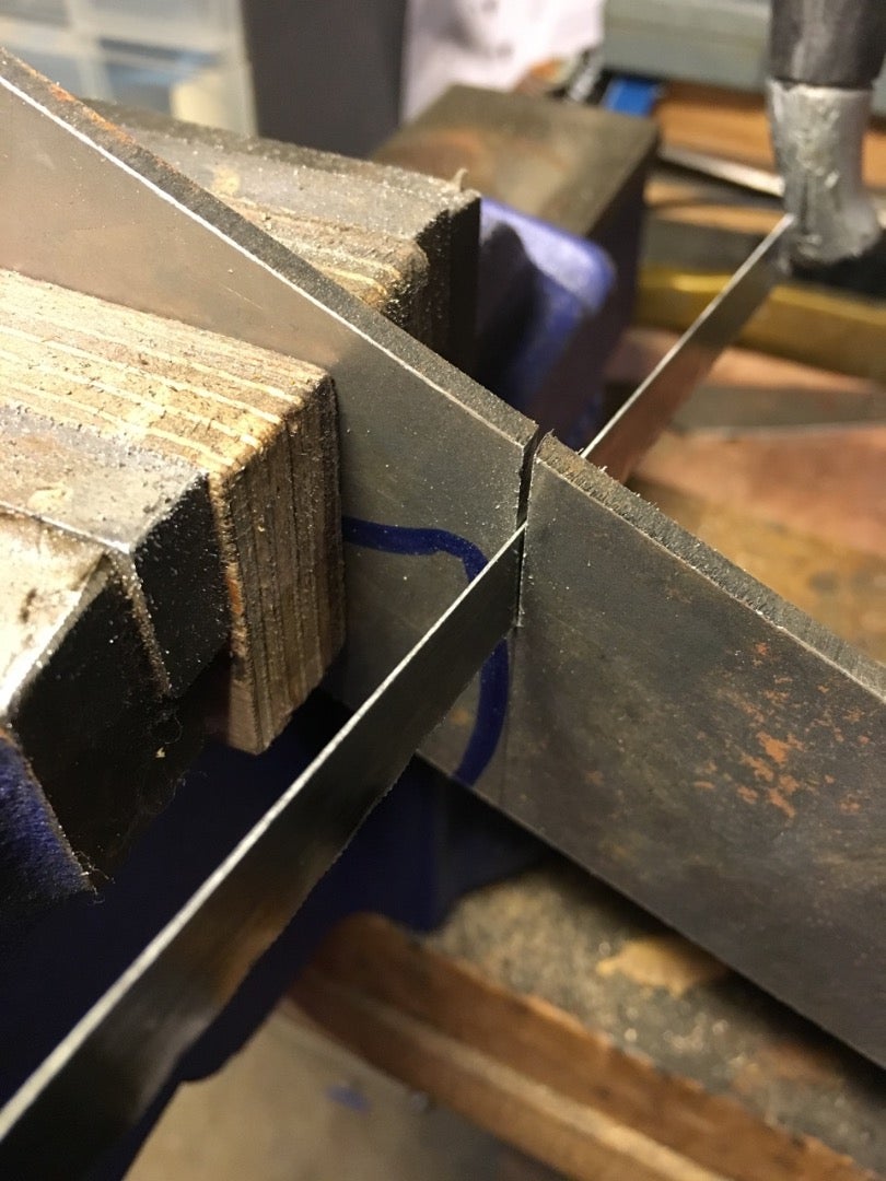

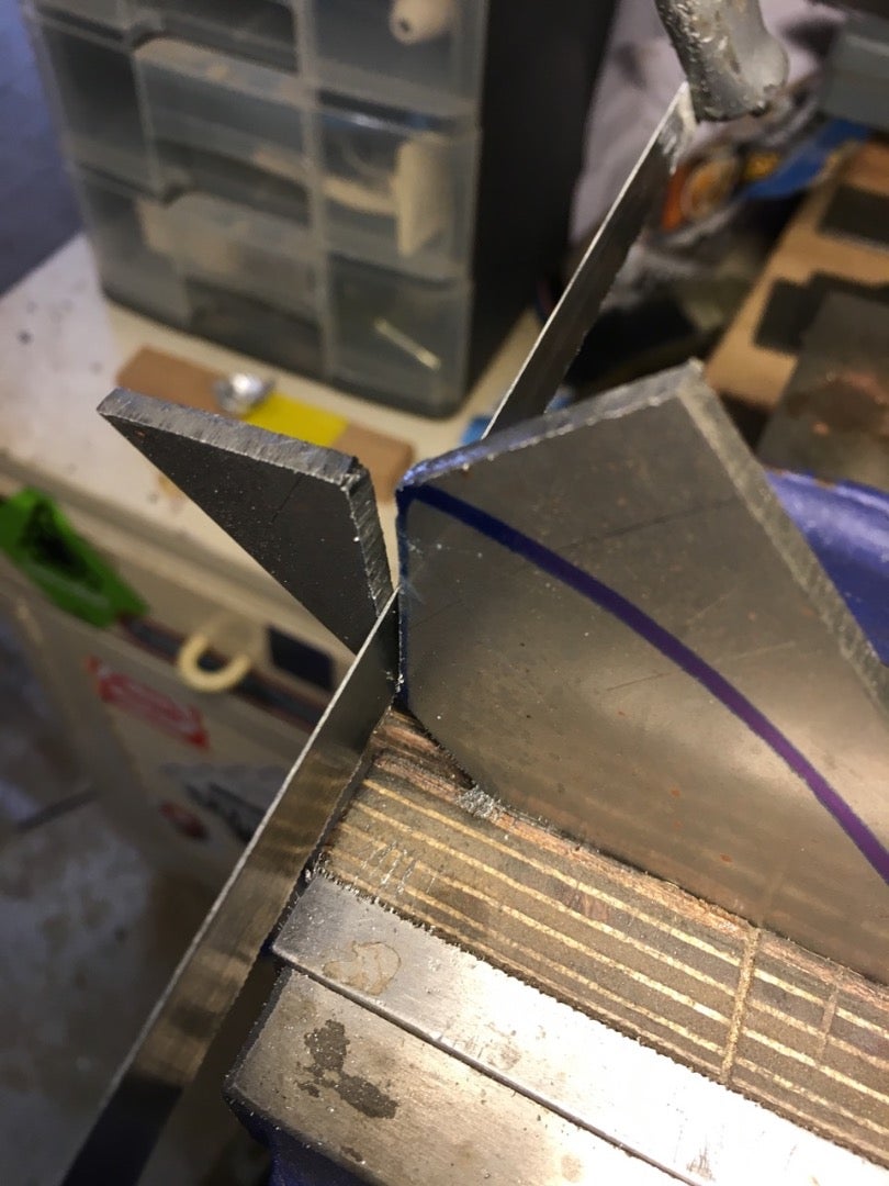

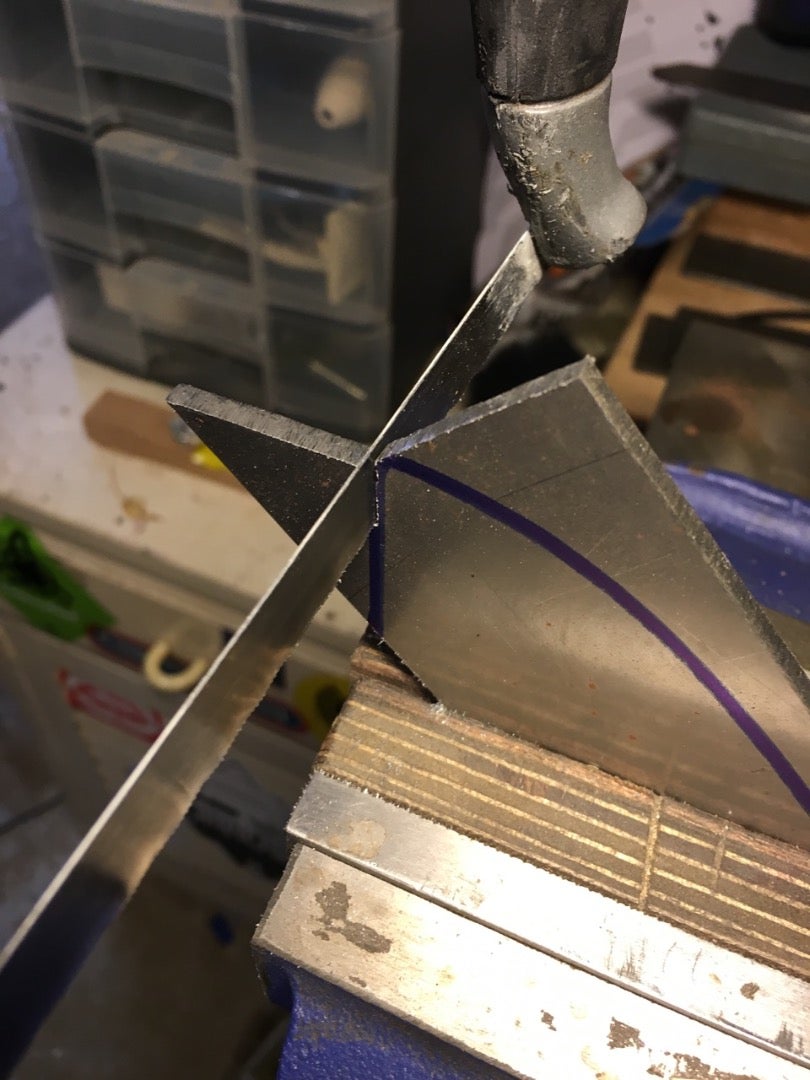

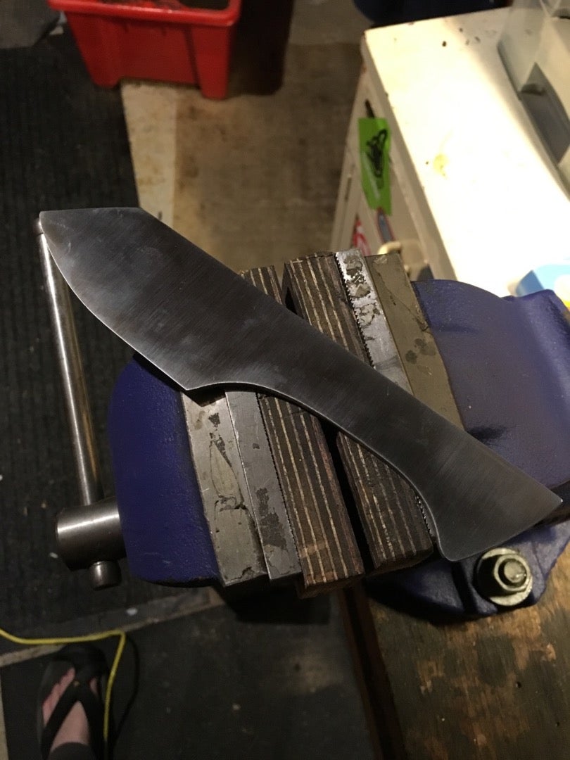

I used a hacksaw and roughed out the shape by hand. This took a fair amount of time, however it's probably still quicker to cut as much metal away as you can, rather than trying to file it or grind it away.
Cutting the shape out also means that you might end up with some interesting shaped offcuts, these can be made into Kiradashi if you want
https://www.instructables.com/id/How-to-make-a-Kiri...

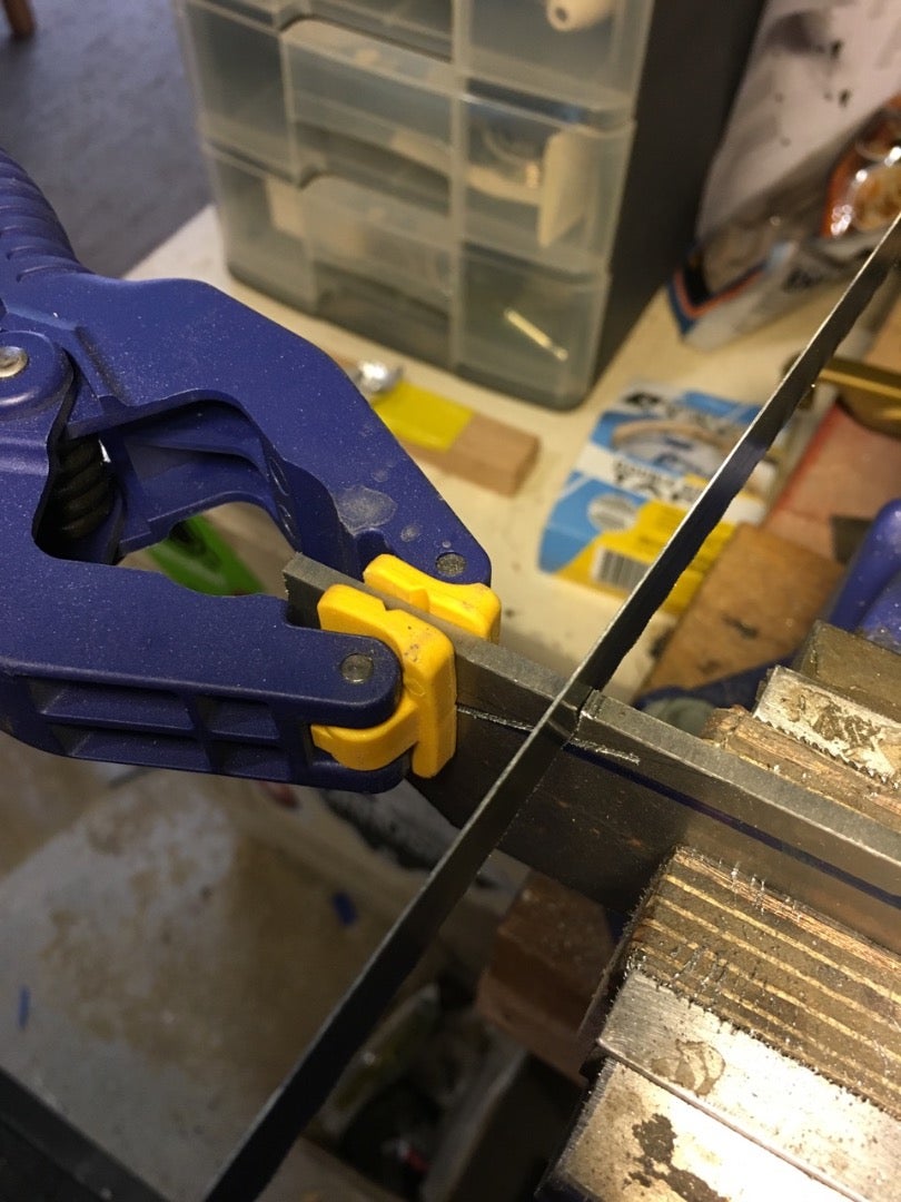

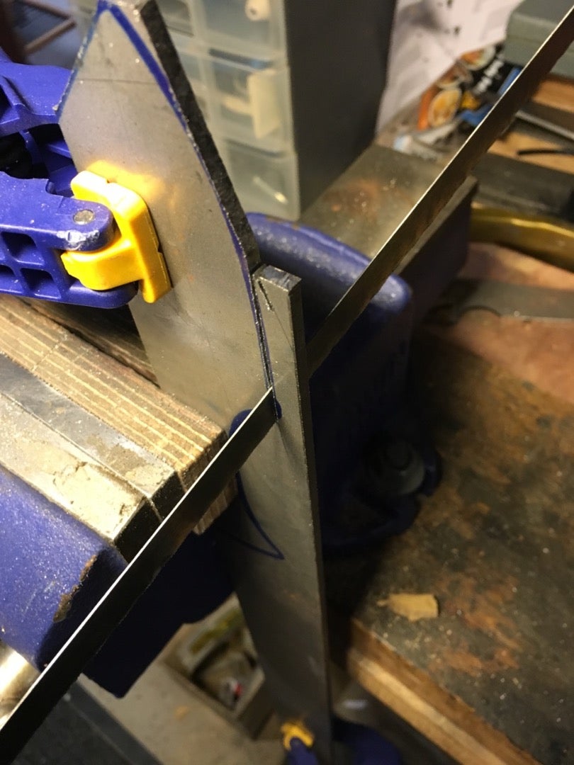

Cut, cut and then cut some more. I scribed some lines in with pencil to work out what the best cutting angles would be as I can't cut a curved line with my hacksaw blade.
You might notice that although I've got the steel clamped in the vice (using some magnetic wooden soft jaws I made) I've got some small clamps on it - I found that putting the smaller clamps at strategic places made it a lot quieter to cut. Particularly when there's a long thin bit being cut, it screeches quite loudly. Clamping it dampens the noise considerably.

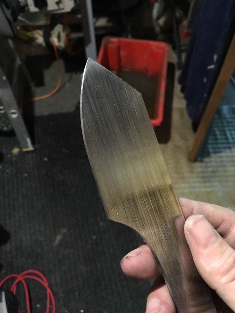

Step 6: Start Grinding
Before grinding the bevels, I made sure each side was flat.
A belt grinder isn't perfect for this as the platen on the grinder is often not perfectly flat. If you're really going for a perfect flat finish, a disk grinder is good and a surface grinder is even better. I don't have any of these tools however so it was off to the belt grinder for me.
If you don't have a belt grinder, or if you're after a perfect finish, this step can be done by hand. Get some successive grits of wet & dry paper and a smooth, flat surface like a piece of glass. Put the abrasive paper on the glass, with the abrasive side up, wet it all down and go to down sanding the flats of your blade.
I ground down the flats with a 50-grit belt and then started grinding the bevels. I then used some finer grits on the flats once I had the bevel ground in. In hindsight, this was the wrong way to go about it all as it got rid of the nice sharp line I had between the bevels and the flat of the blade. Next time I'll get both flat sides of the knife almost finished completely before grinding in the bevels on the blade.

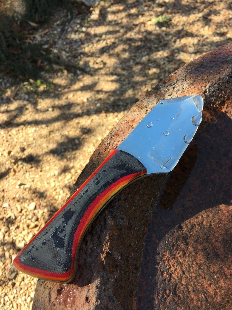

Step 10: Finish and Sharpen the Blade
Get back on the grinder, or back onto the wet & dry, and get all the scale off the surface of the blade.
Once you've cleaned it back up, sharpen it. I'll post an instructable on sharpening blades in the future.
I used a Ruixin brand Chinese clone of the Edge Pro which does an acceptable job, but it doesn't put a mirror finish on the bevel or anything like that. I've got a Lansky kit on order which I'm hoping will do a much better job.
Either way however, it's sharp enough to cut through a phone book...

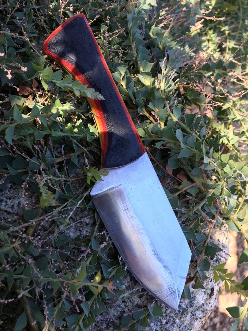

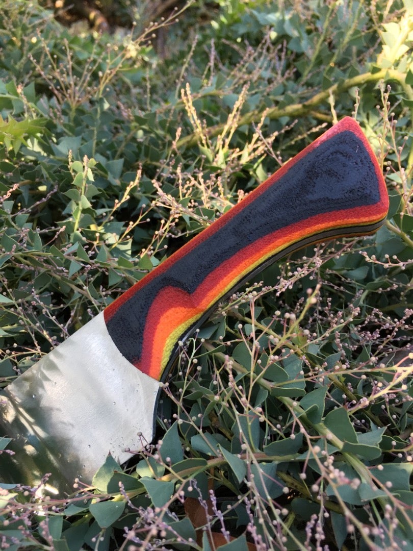

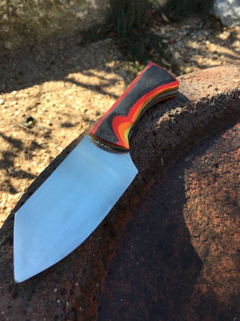

Step 11: The End Result

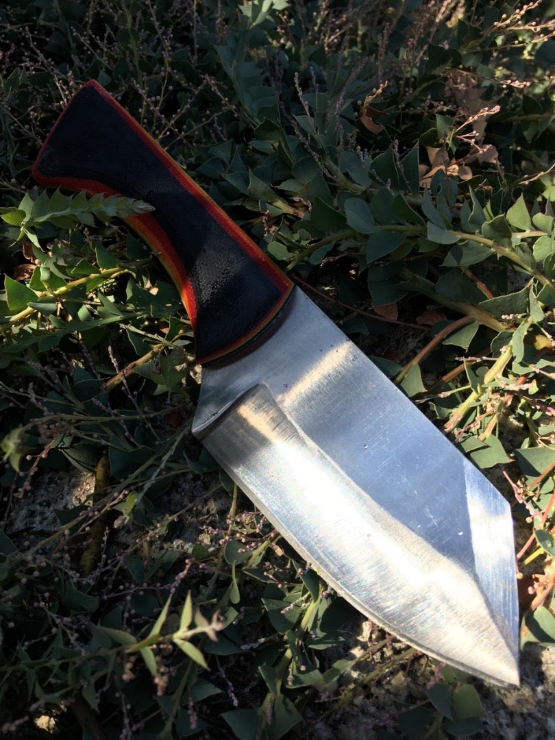

I've finished the knife off with some home-made cotton canvas mircata handles. I'll post an Instructable at some stage detailing how to make the mircata, it's really not that difficult.
The handles were glued on with 2-part epoxy (I used JB-Weld, but in hindsight I should have used something that was clear, or black) and clamped in place. Once the epoxy had cured (4-5 hours in the warm sun) I shaped the handles
The finished knife is pretty rough in some spots, but now I have a better idea what to do next time (and, more importantly, what not to do next time).
Sharp #1 finished! On to the next one.
