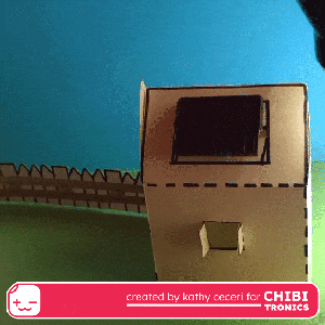

This house and garden fence was designed to be simple enough to cut out by hand. You can print the template for both on one sheet of 8 1/2 by 11 inch cardstock.
Inside the house is a white Circuit Sticker LED that shines through the frosted window. The fence is decorated with red, yellow, and orange LEDs. Those colors will light up even when the amount of electricity produced by the solar panel goes down. (LEDs towards the red end of the color spectrum will run on less power than colors towards the violet end, like blue.)

Use double-sided tape to attach the solar panel to the outside of the roof, as shown on the template. Pull the wires through the flap to the inside. Then fold up the house, taping all the corresponding edges together using Scotch tape. I used conductive fabric tape patches to connect the solar panel wires to the copper tape, then applied the Circuit Sticker LEDs.
Step 5: Finish the Solar House
Once you’ve got your circuit completed, test it by shining a flashlight, the light from your phone, or a desk lamp on the solar panel. It will also work in a sunny spot indoors, or outside. (Again, be careful not to overheat your electronics by leaving it in strong light!)
