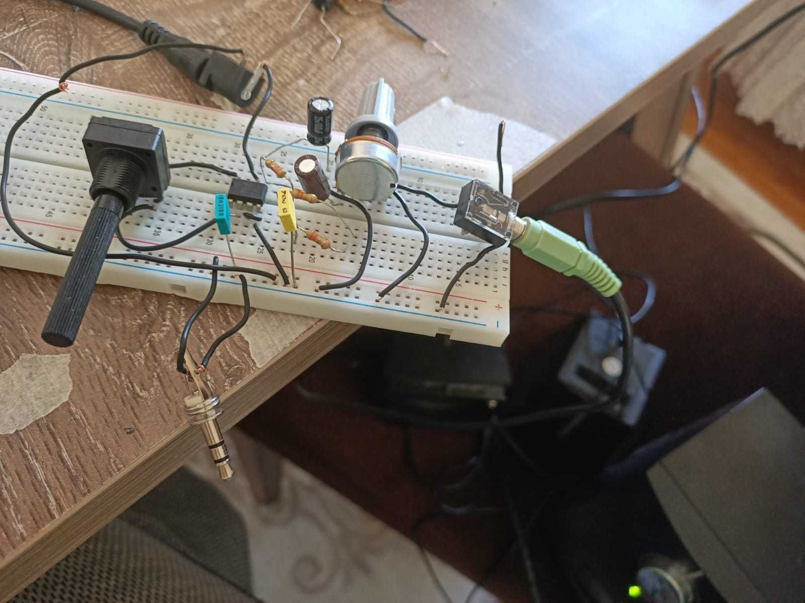

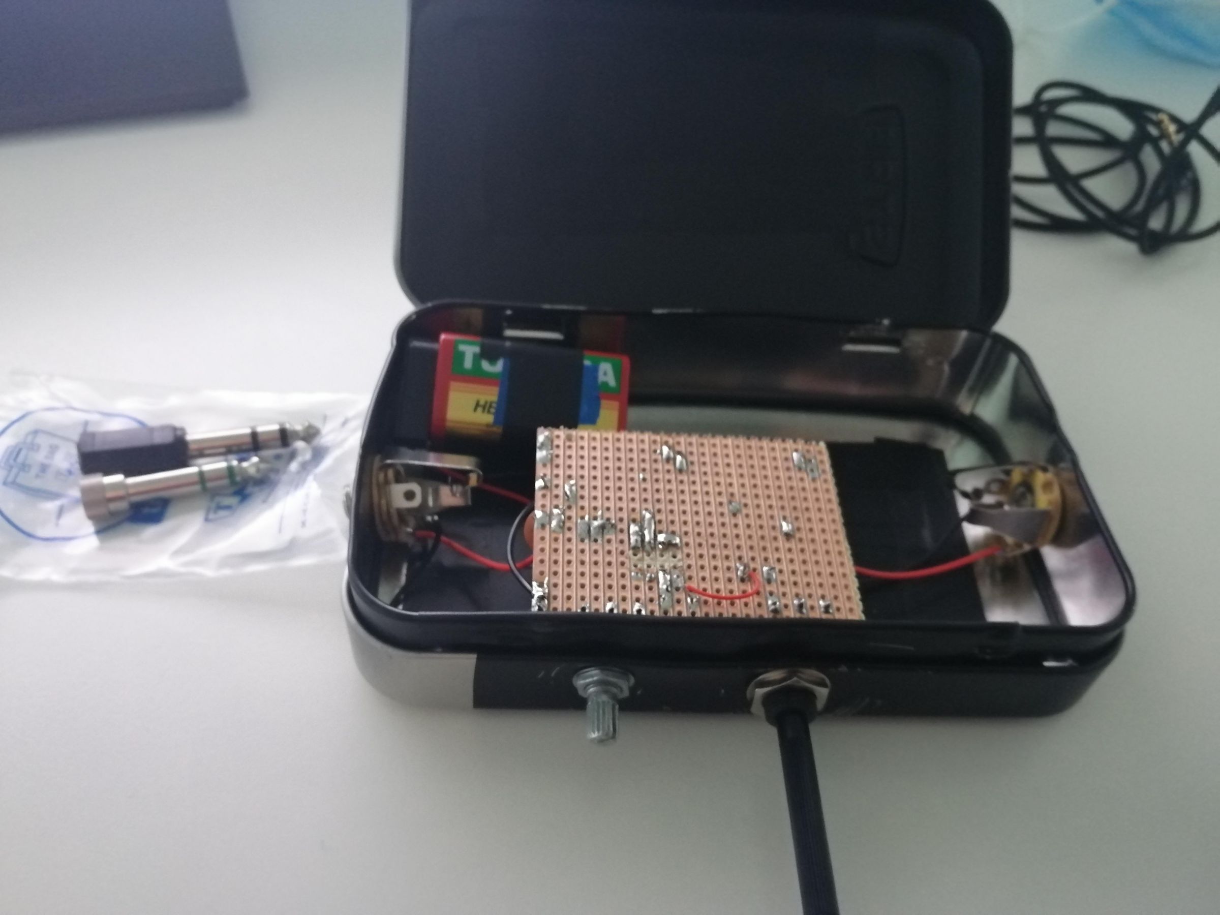

Step 3: Placing the IC
1- Place the LM 386 in the project board as show in the image.
2-If you pick the IC in front of you (so you can read what is written on it) then the lower left pin is 1 and the pin number increase anticlockwise.Take a wire and join the 3rd pin to 4th pin(GND pin).
Step 4: 0.0.1 Capacitor
Join the one pin of 0.01 capacitor with the 2nd pin of IC. The other pin of the capacitor should be joined with the INPUT.
Step 5: GAIN Controller
4-Now join the 1st pin of IC with the A pin of the 5 k ohm variable resistor.
Join th A pin of this variable resistor with the C pin.Lastly join the 8th pin of IC with the B of this variable resistor.This becomes the GAIN.
Step 6: 100 Micro Farad Capacitor
5-Join the +ve side of the 100 micro Farad capacitor with 6th pin of the IC.The -ve of this capacitor should be joined with GND pin (4th pin of IC).
Step 7: 10 Ohm Resistor & 0.047 Capacitor
6-Join the 5th pin of IC with one side of 10 ohm resistor, the other side of the resistor should be joined with the one pin of 0.047 capacitor. The second pin of the capacitor should be joined with the GND pin (4th pin of IC).
Step 8: Volume Controller
7-Now again join the 5th pin of the IC with the +ve side of 220 micro farad, the -ve side of the pin should be attached with the A of the 100 ohm variable resistor.The B pin of the variable resistor should be connected to the GND pin (4th pin of IC).This becomes the Volume controller.
Step 9: Input and Output
8-Join the +ve pin of the 3.5mm stereo jack female with the C of the 100 ohm variable resistor.And the GND of the female jack should be attached with the GND of the IC (4th pin of IC).
9-Join the +ve of the 3.5 mm stereo jack male with the other side of the 0.01 capacitor and join the GND of the male jack with the GND of the IC.
Step 10: Testing
10- Last but not the least join the +Ve of 9V battery with the 6th pin of IC and -Ve of the battery with the 4th pin of IC.
Congratulation !!! you have made your own simple audio amplifier.
Now the time to check it out.Join the male jack with your mp3 player or musical instrument and female with the speakers.Now adjust the Volume and Gain to get the best and loudest possible sound.I should notify you that with this amplifier only one speaker will work.And do the adjustment from low to high.Do the adjustment carefully or it can damage your speakers.

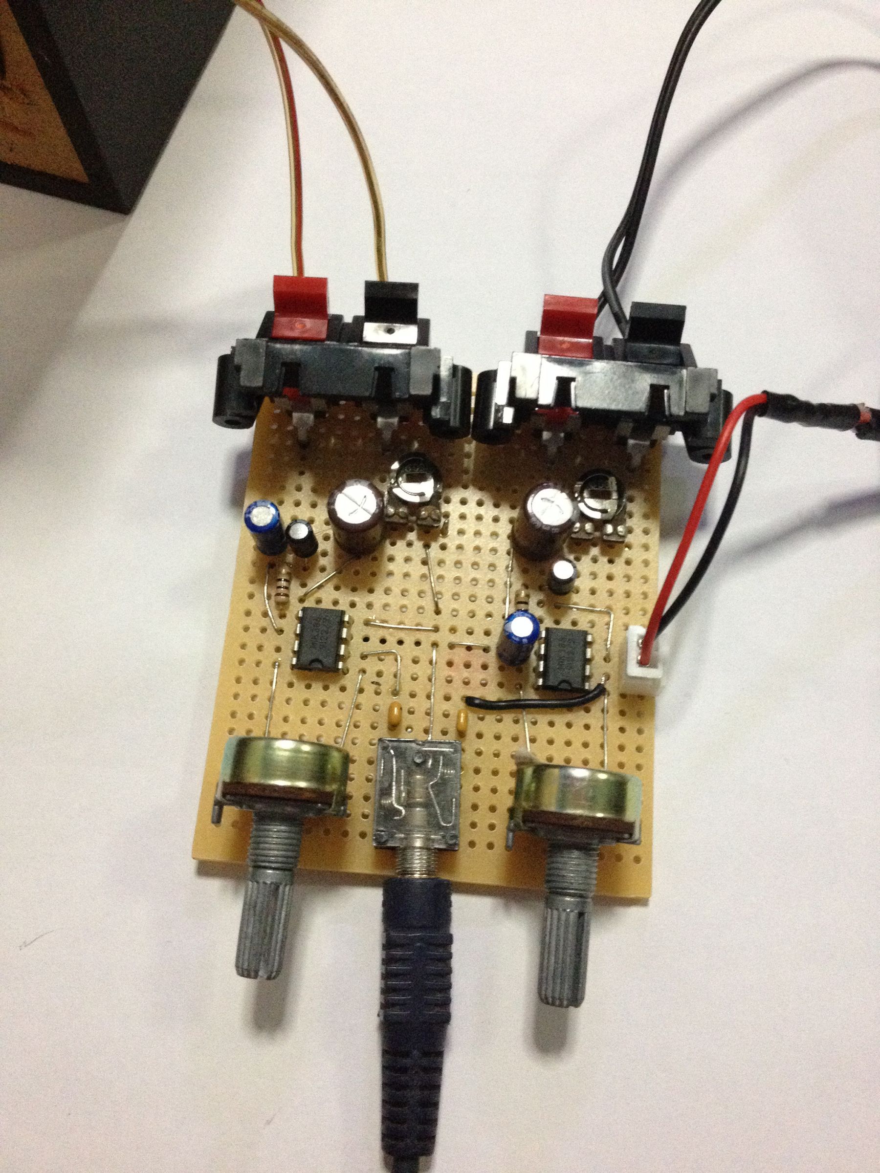

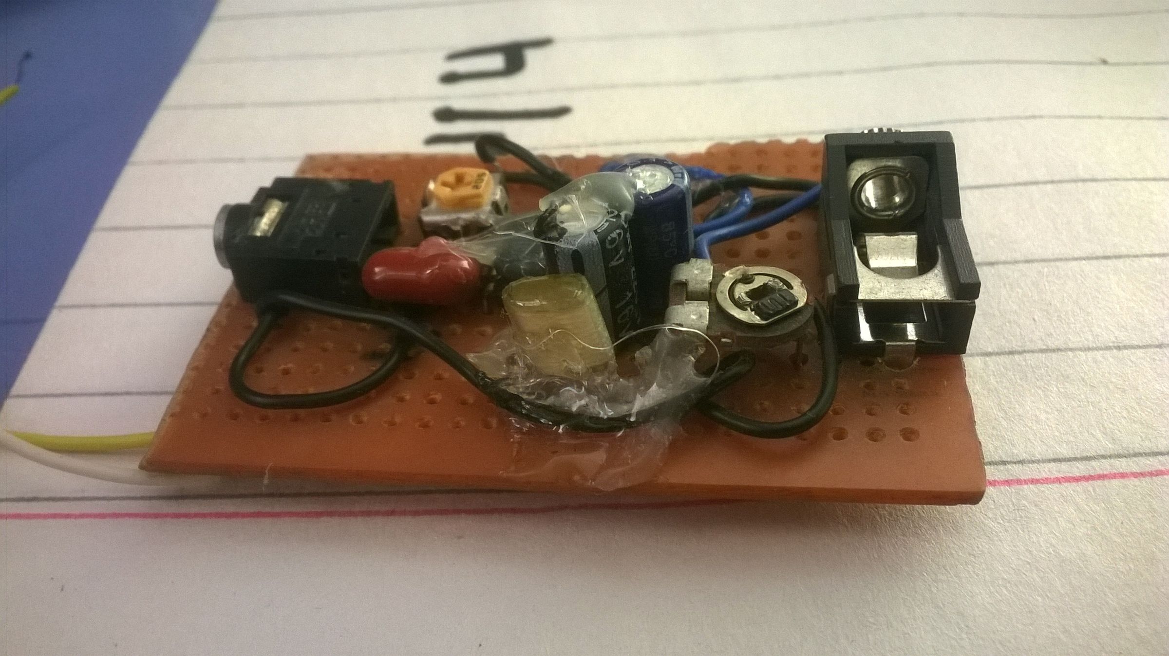

I used 2 LM386 chips and did mine on a pcb. At first the sound was soft and easily distorted. I then went to check out the data sheet for LM386 and realized this chip could take 18v max. So I dug around my box of old power bricks and settled for a 14v 3A one and I must say it sounds a million times better!!

pikapie
pikapie
Reply 6 years ago on Introduction
Haha what i did here is exactly the same as the instructions mentioned above. The only thing i did different was that i did mine on a PCB and added a few extra components which were then 2 connectors for the speakers, a female stereo 3.5mm audio jack and another connector for power. Since the Lm386 is a mono amp, i used 2 for stereo. I just did the same circuit twice on one PCB and shared the power between the two. The audio input for both circuits is combined into one female stereo 3.5mm audio jack for easy usage. I also bridged alot of connections using the snippings from the components (i try not to use wires) which makes for a nicer looking finished product. Thats pretty much it. Happy building!!

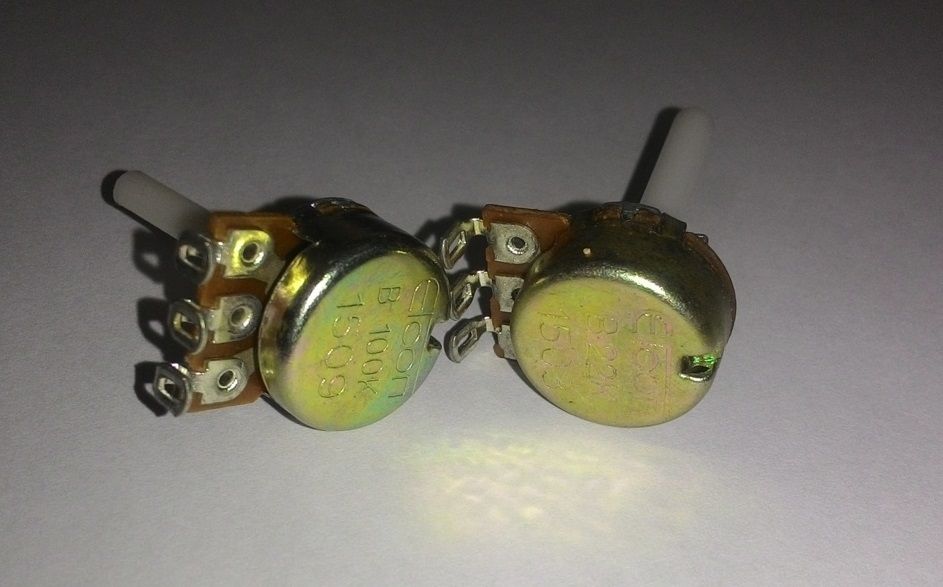

AswanthA
AswanthA
4 years ago

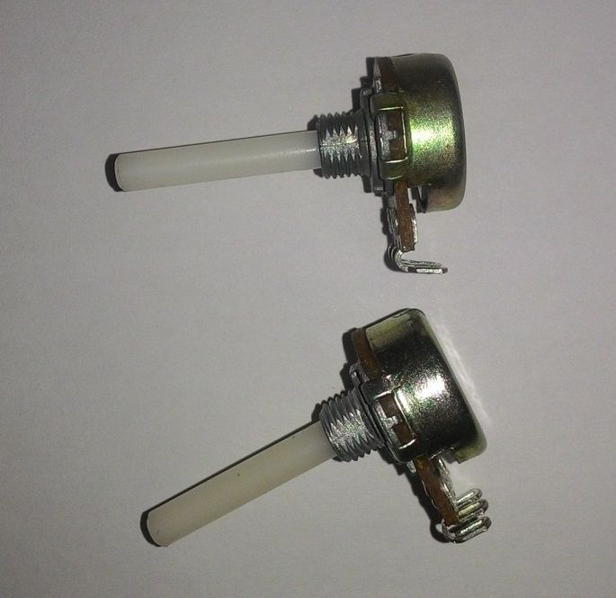

I went to an electronic shop and asked for the 5 kilo ohm variable resistor and 100 ohm variable resistor. I got somethings like this (Look at the images attached). Is it really the component needed for this project? Can I make this amplifier using that? Please. Someone help me out.
0
seal6000
seal6000
Reply 4 years ago
Yes those will work. The one on the right looks like it's a 22K though, it says it on the bottom of the metal can.
