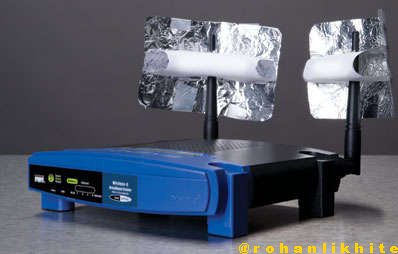

Plagued by unreliable Wi-Fi connectivity? Just found a cheap and relatively easy way to boost a wireless routers signal strength by creating a simple parabolic reflector dish to direct Wi-Fi signals to your intended receivers.

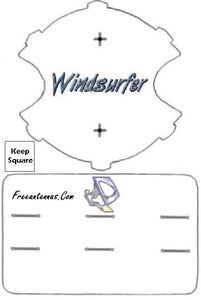

- Template Parabolic Reflector Template
Step 2: Assemble Your Wi-Fi Extender
Print out the template on a sheet of regular paper. You can actually scale the image to a larger sizewhile maintaining the relative dimensionsfor a stronger focus. First, cut out the template pieces, then use a glue stick to affix foil to the front of each piece. Use a knife to make cuts on the indicated slits and bend the reflector to fit the six tabs into the respective holes.

Slide the booster over the existing antenna of your router and point it in the desired direction.

    It works great!
    Yesterday had 30kb per second, now it's more than 100 kbps.
    And it's with antenna printed on A4 page both parts.
    Thanks!!!!

    Best to do... I have an router in one part of the house, and i bought couple of dollars hi-gain antenna (-9db), putting it on extended cable from router - ebay helps...
    Wi-fi extender as described here helps you in case where you can focus your antenna in specific direction - then you only put aluminium foil over the printed part, and make 2 holes in it - putting your antenna through.
    So, very much depends on what you need

    What if you don't have attena? Will it still work?
    0
    Chollyfish
    Chollyfish
    Reply 6 years ago on Introduction
    Sorry, but no. This only works with external antennas.
