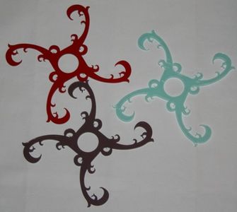

Step 2: Aesthetics
Here is where we make the glass holder functional, but at the same time you can add your own artistic flair. In all essence you are creating a hook with a hole on one end, incorporating the specs from the previous step. It can be as basic as a block design that connects the 2 elements, something with more flowing lines or just let your creativity unfold.
What needs to be taken into consideration is the material that will be used and the width required to support the weight of the wine glasses. I have used a 3mm acrylic, but plywood, MDF and stainless steel would work just as well.
With the acrylic in mind, the width of material around the bottle neck should be at least 8mm, and the hook arm at least 5mm. I imagine you could get away with a lot less in stainless steel.
The pictures show the different levels of design flair.
Step 3: Repetition
Here's where you can decide if you prefer drinking alone, dinner for two, or entertaining a group.
The wine glass holder works great for a single glass, but the design can be replicated to carry as many glasses as you like. I have gone all the way up to eight standard wine glasses.
Repeat your design keeping the centre of the bottle neck holes centred. It is ideal to space the hooks evenly to allow the wine glasses to balance each other out.
