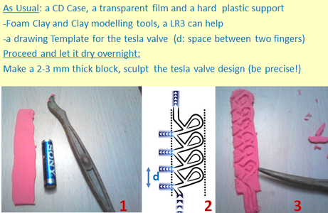

Step 2: Inventory and First Project Part
Inventory:
-Foam clay
-paper towel
-modelling tools for clay
-CD case/hard support and transparent film
First part:
Take foam clay and realise a straight and uniform sheet of foam clay : L 10-15 cm, l 3-4 cm , thickness at least 2 mm (0,2 cm) with help of CD case and transparent film
Then sculpt the Modular Tesla Valve design as shown on the picture 3. Make the design broad enough (about 2 mm broad must be enough).
Do not forget the Openings on the sides (see picture 2 for this formal Tesla Valve design!
Then let it Dry under weight to keep it flat.
Step 3: Complete the Modular Tesla Valve
Make a second sheet with dimension slightly bigger than the original but thinner. (1 mm)
Then wet the surface of both sides and press a little the new sheet of foam clay onto the modelled one with the CD case. Press again but more firmly by rolling a LR battery on it to obtain a uniform adhesion of the new sheet onto the modelled one.
Do not overpress, otherwise you will risk closing completely the design by letting clay into the "hollow tubing part". And then it will not work... But you need also to get good adhesion between two sheets...
You need to find the right way to do it. Good Luck Dude!
When you achieve this step, sculpt the tesla valve. Do not close the openings on the side! Close the other parts, so that flow cannot escape at the interface between both sheets.
Also this must not happens., it is just to insure it will work.
Last Step: Let it dry under weight as usual to get it flat otherwise it will be wavy... and this can be a problem.
