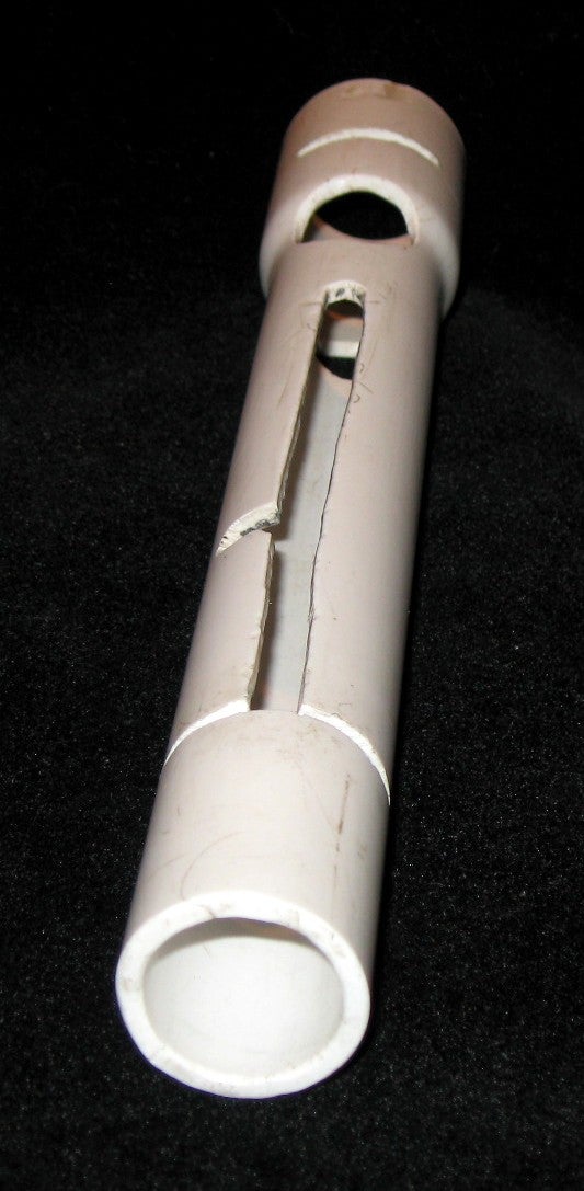

Place a mark on the line at 2 3/4" from the bottom ( flared end ). The impact punch will make
an excellent mark.
Drill a pilot ( 3/16") hole straight  through both sides of the tube, then drill a 3/4" hole through
each of the pilot holes [ image #3 ].
These holes will admit the shelled nut into the cracking zone on top of the Anvil and will be
enlarged in a later step.

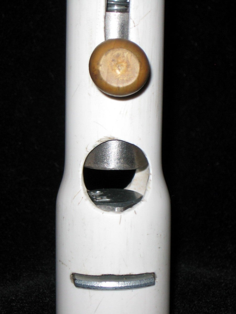

Thin Cross Slot ;
Mark ( draw ) a circular line around the tube 1 7/8" from the top end, then use the hacksaw to cut
just less then halfway through the tube. I then used the Dremel to expand the Cross Slot to 1/8",

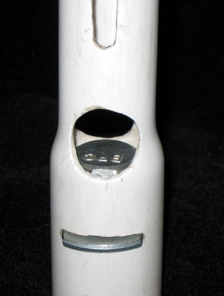

  Wait a moment   !
In typing this step I've just had an  epiphany ,  which is;  if your hacksaw can hold more then
one blade at a time, cutting this slot should be much easier.
Put two blades in your saw and cut the tube as before and the Thin Washer will fit snugly
into the slot [ image #1 ].
I just test tried a two blade saw cut on a scrap of pipe and it worked!
This is so much easier then using the Dremel to make the slot.

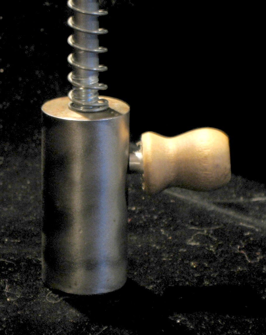

Step 5: Make the Hammer Rod
The Hammer Rod is a 2" length cut from a 1" diameter iron rod [ image #1 ].
Use the hacksaw ( just one blade ) to cut the rod, it is not a critical dimension.
Now drill a 1/4" hole in the center of the rod ( any end ) 1" deep [ image #2 ].
Tap this hole for a 5/16" bolt ( 18 threads / inch ), Call this the Hammer top.
Use a #29 bit to drill a hole 5/8" from the top and a 1/2" deep [ image #3 ].
Tap this hole for the 8/32 Pull Knob machine screw.
Step 6: Making the Hammer Subassembly
Just make two pieces more for the hammer sub-assembly.
Thin Washer ;
Take and mark the Thin Washer as shown in [ image #3 ].
The first saw cut should be the middle flat.  Mount the washer in a vice or locking pliers.
Use the hacksaw to make a straight cut 1/4" away from the hole edge.
Release the washer and make sure the the side marks will leave a 1/2" length in the
center after next two cuts.
Mount the washer in a vice or locking pliers again and use the hacksaw to make a side
cut 5/8" from the top center of the washer [ image #3 ].
Repeat this process finishing the Thin Washer modification which should look like the
left side of [ image #4 ].

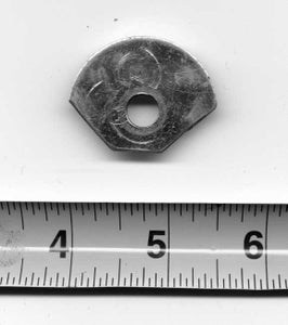

Pull Knob ;
Depending on what kind of wood Pull Knob you find, you will need to drill a core into it.
The cored diameter should be 1/4"  same as the standoff diameter, [ image #5 ].

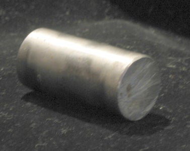

Screw the standoff on the 8/32 machine screw. Leave 3/8" thread sticking out [ image #6 ].
Hot glue the screw with standoff into the wood Knob leaving about 1/4" of the standoff
exposed [ image #6 ].

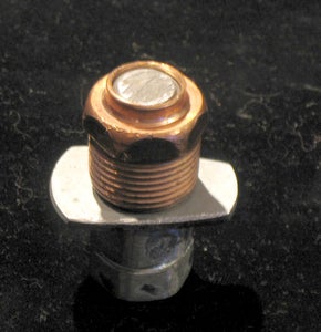

Step 7: Make the Anvil Subassembly
Cutting the Thick Washer ;
Mark 1 3/4" diameter 1/8" Thick Washer as a centered wedge [ image #2 ].
Use the hacksaw to make the cuts to create the wedge and lightly file the sharp edges.
Now, you should see how this Thick Washer wedge slides into the bottom slots of
the PVC tube and make any adjustments needed for this necessary fit.

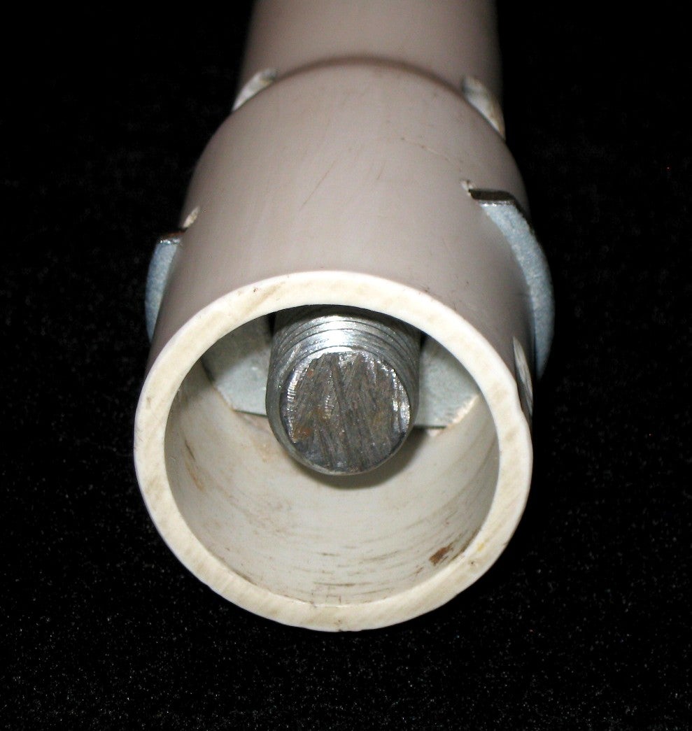

Nut and Bolt ;
Take the bolt head and see how it does or does-not slide through the tube.
Hand file all six corners and use the tube as a Go / No-go test gauge.
Continue filing the corners and gauging the fit until it easily slides through the 1" tube.
Now repeat the hand filing of the nut corners until it also slide easily through the tube
see [ images #4 and #5 ].
See the up-side-down [ image #6 ] of the Anvil sub-assembly.  Note the wedge thick washer
held in place by the copper massive nut.
Remember the copper nut mass can be replaced by multiple washers and a 5/8 nut.

Insert the wedge thick washer into the two  bottom slots of the tube. It should only go one way.
Keep the wedge centered by hand and slide the bolt and nut, threads first through the tube top
see [ image #2 ].
Enlarge the 3/4" hole ;
Now eyeball the front 3/4" hole and enlarge it with a round file until it looks like [ image #3 ].
Do this on the front side.
Be careful to only enlarge the hole in the vertical direction, because enlarging in the horizontal
will weaken the nutcracker.
This will necessitate sliding the Anvil bolt in and out, until the holes are satisfactory.
The back side hole should be smaller then the front side [ image #3 ].
Lastly, attach and tighten the heavy copper nut [ image #4 ].

Slide the Hammer rod, smooth face side first, into position with the 8/32 threaded hole at the
bolt latch [ image #1 and #2 ].
Screw the pull Knob into the 8/32 threaded Hammer rod [ image #3 ].

Two Handed Fast Method ;
Being right handed, hold the Nutcracker in your left hand fingers covering the back smaller nut
access hole. Hold the nutcracker at 45 degrees off the horizontal. Use the left thumb to push
the bolt Knob up just enough to drop a Hazelnut onto the Anvil, your left fingers keeping the nut
from rolling out.
Use the right hand thumb to draw the pull Knob up near the Bolt-Latch. While covering the top
hole with your left thumb. Now release the pull Bolt to crash the Hammer into the nutshell.
A ready to eat nut and shell fragments should fall into the fingers of your left hand [ image #4 ].
If  the nut-meat is smashed, shorten the length you pull on the Knob for a softer hit the next time.
If not cracked, you want to pull the Knob further for a stronger hit and try again.
The way the nut rests on the Anvil will affect how it cracks open.  See what works for you.
