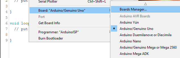

1: So go to the Arduino IDE and select the "Tools" dropdown menu
2: Now hover over "Board" and select "Boards Manager..." at the top
3: In the search box, type "intel edison". Only one thing should come up (If not, look at the pictures to make sure). I already have it, so for you, instead of it saying "Remove" it should say "Install". Press install and wait for it to install. Also, you should install every driver that it asks you to.

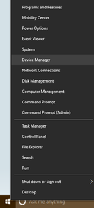

First: Right-click on the windows button and select device manager (You can also just search for it on your pc)
Second: Select the dropdown menu called "Ports" and take note of the virtual com port of the Edison
