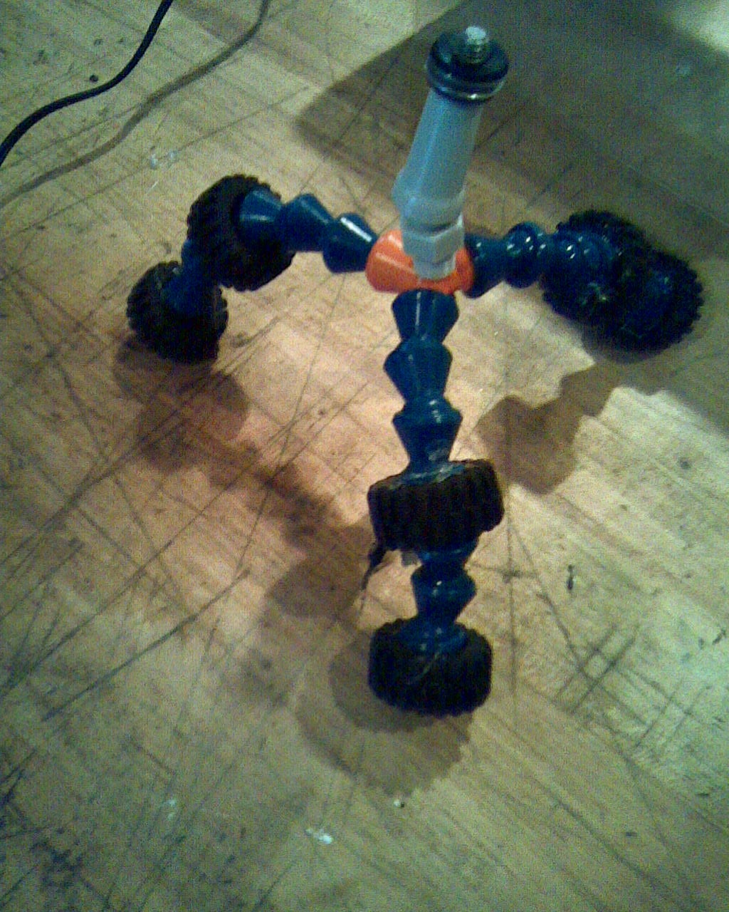

Step 2: Make the Divider and Attach the Legs
Get the three way segmented hose divider.
1. Drill a hole in the center as shown. Hole should be the diameter of the 8-32 bolt (about an 11/64 inch bit). Attach all the segmented hose segments into three equal sections. Then snap on the segments to the divider. See the pictures if you get confused.

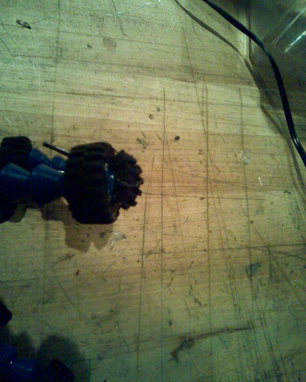

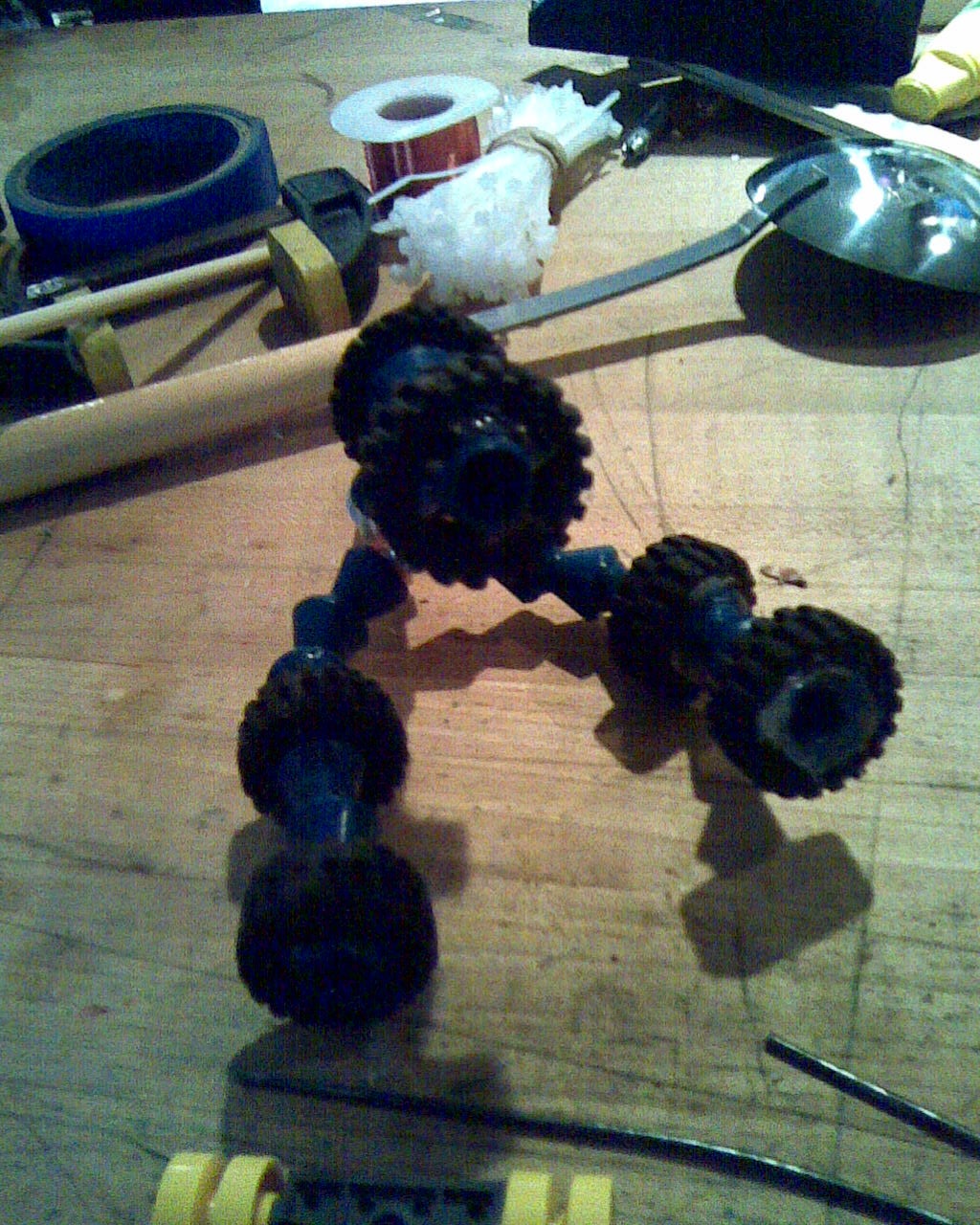

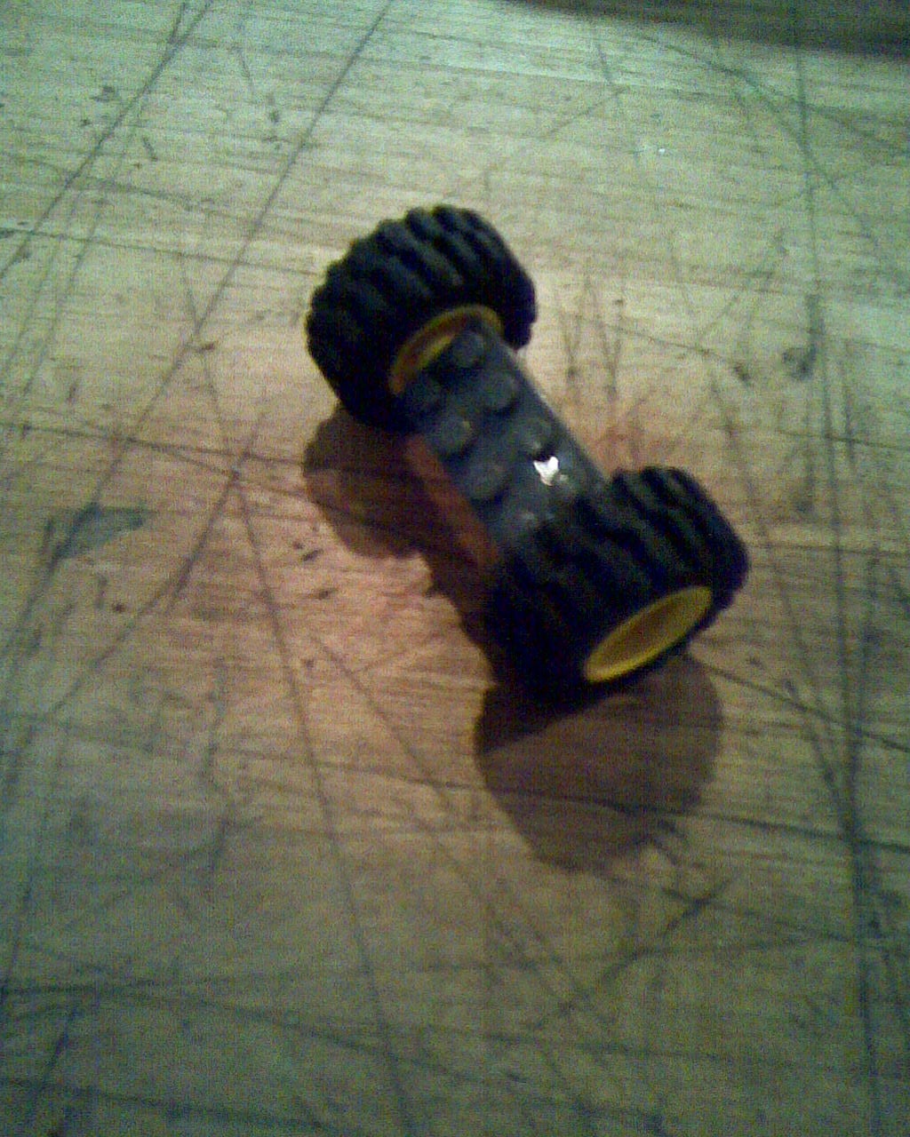

Step 5: Adding Grip
In this step we will add some grip to our Gorilla Pod. This step is optional, but recommended. I used some Lego tires. They will be secured with hot glue. Thanks to Duck Lemon for the idea to use Lego tires!
1. Put tires onto the legs, two on each leg.
2. Glue them in place with hot glue.
3. Cut one tire into three or four sections with wire cutters or scissors.
4. Glue one section onto the end of each leg.
Step 6: Finish
Just snap the camera mount onto its mount, and your finished! Enjoy your new Gorilla Pod you made for only a few dollars! Don't forget to vote for this in the Photojojo Contest! Thanks for looking!
