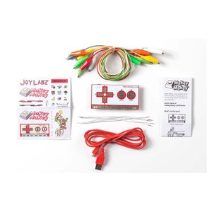

1 Makey Makey
4 Alligator Clips
6 Connector Wires
Wire stripper
USB Cable
Laptop / MAX
People
Step 1: Set Up Makey Makey
Connect 6 wires into the left of the Makey Makey to correspond with W A S D F G
For D F and G connect three alligator clips to distinguish them from the connector wires.
Connect the last alligator clip to the "EARTH" (ground) at the bottom of the Makey Makey.
Have your three buddies hold the ends of the connector wires individually.
These will be routed to different notes in Max.
The alligator clips will be routed to different timbres in Max.
