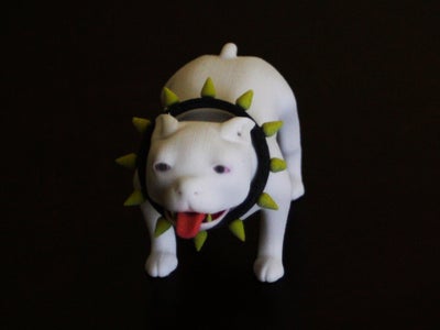

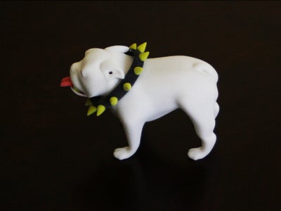

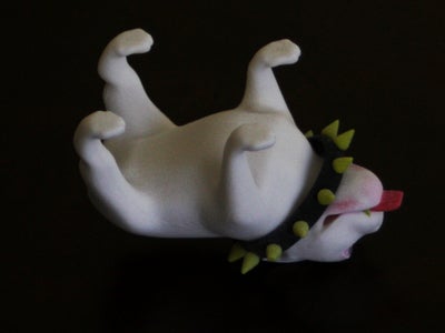

This was printed in full color sandstone.
Some of the important things I learned from making this creation to finish.
1. 3d printing is expensive. So when possible try to hollow out objects.
2. There are thickness that needs to be measured for smaller objects to meet the tolerances of the material used. The walls on sandstone needs to be at least 2mm thick. One of the main reasons I had difficulty was because of the tongue area. A dog is not a dog without it's lapping tongue. I wanted to keep it's tongue and still have it printed in color (sandstone) The model printed is only about 3.5". Similar problem was with the ear. However for most plastics the wall thickness is only 1mm thick. These don't come in color. =(
3. The spiked colar, I wanted it to move freely (spin around the neck), but due to printing restrictions they have been fused together. The only way to get around this is to print separately and have a locking design for the collar. (This will probably be addressed in my next design)
4. Almost forgot this one. When working with smaller models, probably better to give objects a solid color than have a lot of details. Mainly details don't show up in the 3d printing. Please look at the preview of the model instruction #13 as compared to the actual 3d model.. The eyes in the computer rendering has very good detail, but in the 3d printed model it doesn't really show up to well. It would have been better to make the eyes a solid color, but this is a matter of preference.
Thanks for taking a look!
