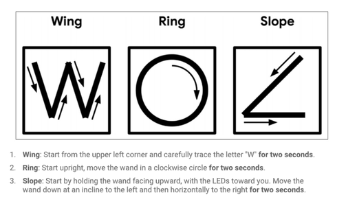

Step 4: Data Collection
The data collection included four classes: Wing, Slope, Ring, and Random class. Sensors reading were collected at 100 Hz frequency, with a sample duration of 2 seconds. So you get 200 rows of accelerometer sensor data for each sample. Check the instruction on how to perform the motion activity for each gesture.
Any other gestures apart from the above are treated as a random class. The codes for data collection are attached in the code section. I attached the summary of the collected training dataset.
In a similar way, collect validation dataset as well.
