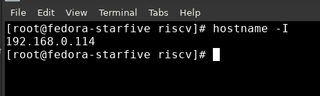

No in order to access this server we need the Ip address of the device. So in order to know that,
Once again go to your Terminal,
type and enter,
hostname -I
it will give you your device's IP address.
Now go to your Web browser and type in,
192.168.x.xxx:8080 <your device ip>:8080 the port
