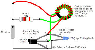

Step 2: Procedure:
Take all the things mentioned in 'things required' and connect them in a order given in above circuit.
Step 3: Result:
You will notice that light glows up brighter and brighter. This is because the electrons in the circuit speeds up its flowing and the magnetic field produced in the toroid core converts into electricity which results in increase of the battery's electrical power.

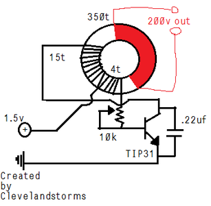

This is a mini joule thief but we can also produce 220v output by replacing the transistor with TIP31 and some small adjustments. I didn't tried this super joule thief but I saw it in circuits.io web site. I hope you will like it and comment or favourite it. Please vote me if you like it.
