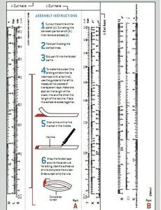

Back in 2008 Instructables member legionlabs published "How to use a slide rule." In the comment section Instructables member Mr ross made reference to a May 2006 article in Scientific American magazine titled "When Slide Rules Ruled." Once that article was available on-line in PDF, but has since been removed. Scientific American still makes it available, but at a cost of about $7 US. The article included a downloadable PDF file pictured in the graphic for this step. It is a printout for a fold-up paper slide rule. I decided I wanted to make one of these just for fun, but mount it on wood and Plexiglass. After printing the PDF file, I enlarged it with a copy machine to about 150%. The idea was that the scales would be larger, easier to read, and more precise.

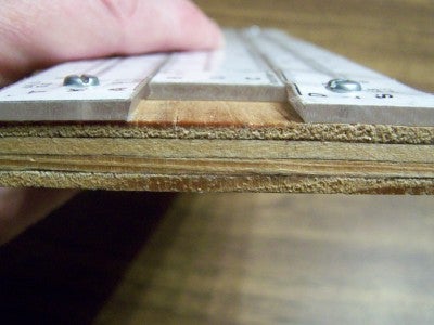

I used Plexiglass screwed to 1/2 inch plywood. In order to hold the slider (center movable piece) in place and still allow it lateral movement, I used a dovetail router bit to shape the edges of the Plexiglass pieces. This slight bevel holds the slider down, but allows it movement.
I covered the Plexiglass pieces with double stick cellophane tape. Then I pressed the paper scales to the tape. I covered the paper scales with cellophane packing tape about 2 inches wide. I trimmed the edges with a very sharp knife.

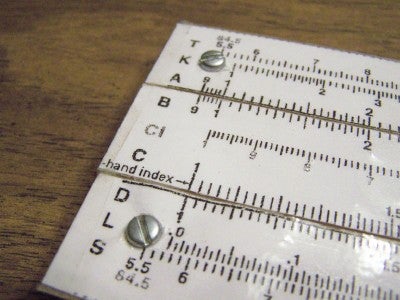

The screws near the D, L, & S scales fit into holes no larger than the screw diameter. The screws near the T, K, & A scales fit into holes that are over-sized so the top slide rule stator can be moved a little left-to-right so the left indices of all scales align properly. The over-sized holes near these scales also allow the top stator to adjust in and out toward the slider for the desired smoothness of movement.

I have not made a cursor for this slide rule, yet. Most calculations I have ever done on a slide rule involve basic multiplication on the C and D scales. The D scale is directly below the C scale visible in the photo. It is not difficult to set the factors and to read the answer on these scales without a cursor. When using the A and B or S, T, & K scales, a cursor becomes more necessary because the answer needs to be read on the C or C1 scales. See the second photo for this step. I used a note card aligned with the top edge of the rule as a cursor. It aligns with 27 on the second scale from the top, which is the K scale. Follow the edge of the card downward and you see it also aligns with 3 on the D scale. The cube root of 27 is 3. Below the K scale is the A scale. The cursor aligns with 9 on the left half of the A scale. The square root of 9 is 3.

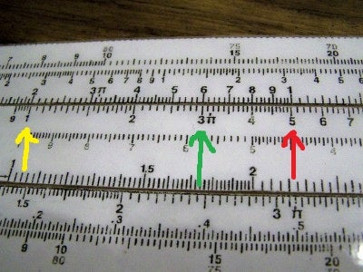

Notice one inherent problem with the PDF file that serves as a pattern for this slide rule. See the first photo again. The left index for the B scale is aligned with 4 on the left half of the A scale. The left index on the C scale below it should very accurately indicate 2 because the C scale gives the square roots of numbers on the A or B scales, but the left index of the C scale is a full line width to the left of the 2 indicating 1.99 as the square root of 2. Calculations done on the C and D scales of this rule are quite accurate, but I found several problems on the A and B scales that are not due to my printer or my construction methods.

The A and B scales are copies of the C and D scales, but in half-size so they are doubled. Multiplication and division problems that may be solved on the C and D scales may also be worked on the A and B scales. Because the A and B scales are smaller, the answers are more difficult to read with accuracy. Notice the yellow arrow in the photo. The 1 on the B scale is aligned with the 2 on the A scale. Move to the right on the B scale and notice the green arrow. The 3 aligns nicely with the 6 on the A scale. 2 x 3 = 6. Although not marked with an arrow, the 4 aligns nicely with the 8, too. But, when you look at the 5 on the B scale, it is at least the width of a line off of the 1 (or 10) on the A scale. It would appear that 2 x 5 now equals 9.97, or thereabouts. The PDF file for this slide rule has some problems that make it unfit for anything but practice by a beginner.
