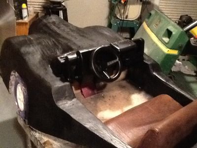

Chopped up the jeep with a sawsall... Preserving the electrical components. Stretched the front abut 4' using an old 2x6 for strength. The side profile was initially sketched on cheap white foam and then hot melt glued to the plastic parts. The cockpit was constructed from 1/8" plywood. Sides and floor. The turbine intake was built with strips of wood and covered in paper mâché.
Step 2: Form - Fill - Sand - Sand - Foam
Step 3: Paper Mâché - Fill With Drywall Mud - Shape With Card Board - Paint With Latex Paint to See What Errors Show Up...
