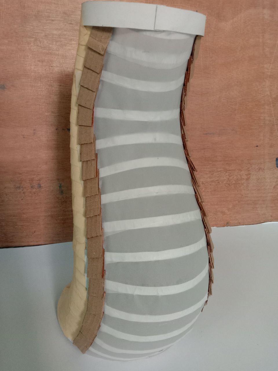

to form the body I cut some 2x20 cm and 2x15 cm mountboard strips.( refer the image 9 )
I started attaching the 20cm strips on the back side of the body from bottom to top using hot glue. ( apply the hot glue on the edges of the side cut outs and don't apply it on the back (B) cut out, its there just to give the required arch to the strip. and cut the excess strips around the edges as the cutouts are gradually narrower from bottom to top)( refer image 10,11,12)
Now I started attaching the 15 cm mountboard strips on the one side of the body from bottom to top. then cut the excess strips( here apply the hot glue on each edges of the side(S) cutout and also on the middle upright portion to form the arch on the strips.)
Similarly did the other side of the body.( refer the image 13, 14 )
Now for the front part I cut 1x15cm mountboard strips and started attaching it from bottom to top giving an even spacing of about 3 cm between two strips( again here apply the hot glue on the edges of the side S cutouts and not on the the front F cutout )( refer image15 )
Now I cut a 2x42cm mount board strip to create a circle of 13cm diameter and attached it to the top of the body, it is where i will later join the head structure.( refer the image 16 )
Now covered the whole body( except the front) with parchment paper strips using adhesive glue) ( refer the image 17)
After it dried I cut a circle of 12 cm diameter from the bottom circle upon which the structure is formed using precision knife. Then carefully cut at where the front F and back B cutouts are attached to the circle at the bottom and the rectangle at the top. ( refer image 18,19 ,20)
For the front i cut some 4x15cm strips of tracing paper and glued them in between each two mountboard strips.( refer image 21 )

First I cut lots of 2cmx3cm rectangles and started attaching them using hot glue along the line where the front part is joining the side part to create a distinct partition .(attach the rectangles from bottom to top keeping the 3cm length along the line ,after attaching one rectangle attach the next one above the first one overlapping about 1cm )( refer image 1 2,3)
To create the scaly body i cut loads of 3cmx3cm small squares using carboards.( use cardboards that are not much thick and can be bend easily for the scales)Then i shaped these small squares into pentagons by cutting two corners of the the squares and bended it along the long vertice using a pen. ( refer the the image 4)
(don't throw away the cut corners as it will be used in the detailing of the head)
Then started attaching the scales from one side of the body to the other side from bottom to top( start attaching it from just beside the partitioning of 2cmx3cm rectangles. After finishing one line of scale attach the next line of scales in between the two scales above the first line. But not always can be done so , some scale will just overlap each other and not be evenly spaced but that's fine ,this randomness gives it a more unique look)( refer image 5,6,7)
